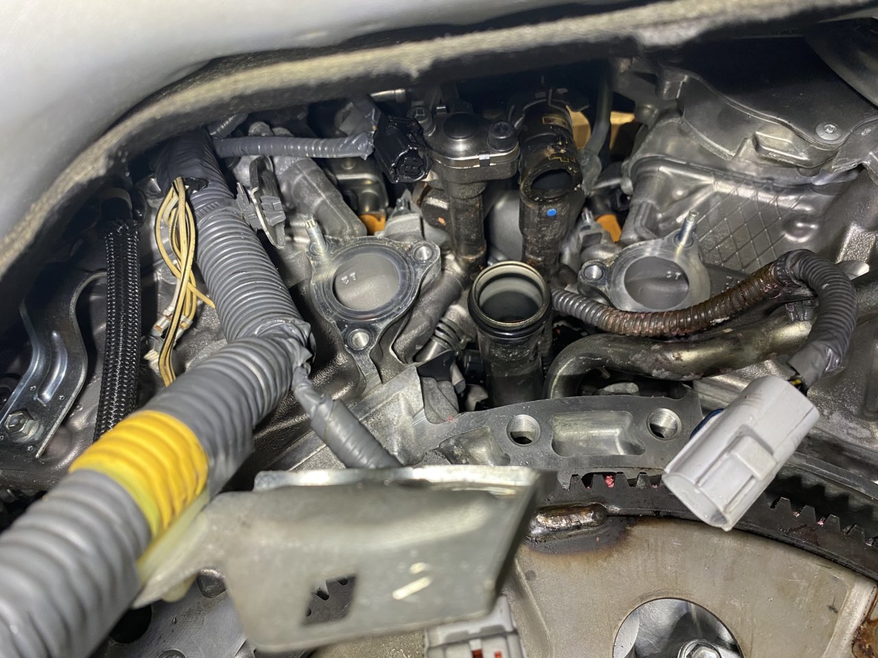

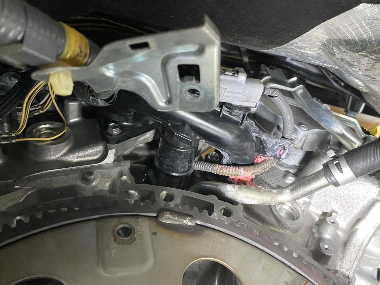

    Got the trans out today. Will replace the pipe tomorrow and then reassemble. If you do it at home, make sure you have a helper!

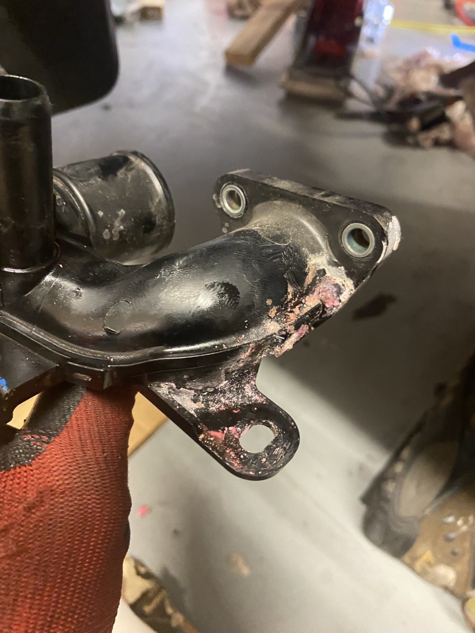

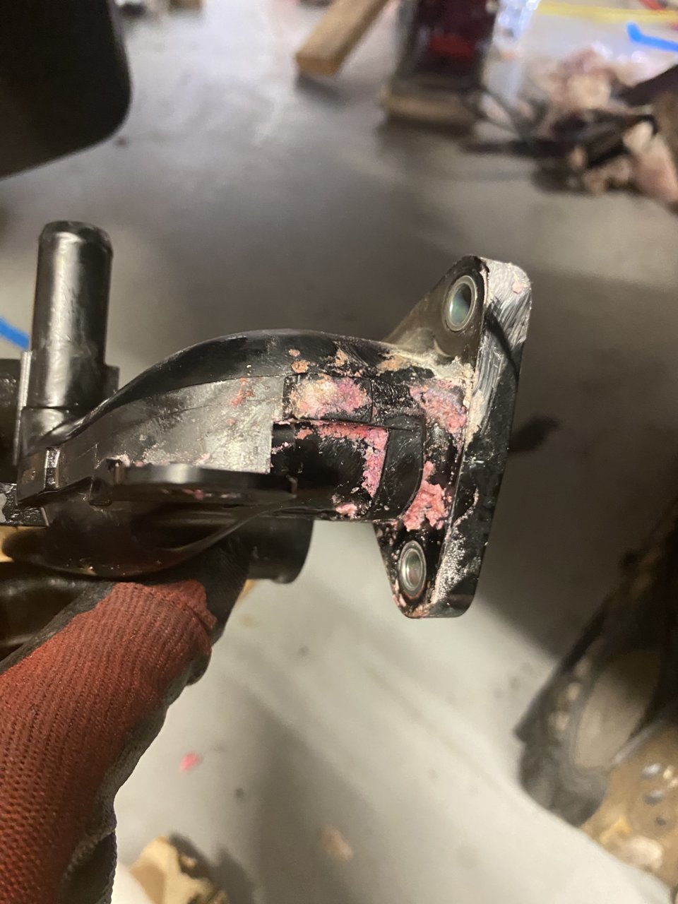

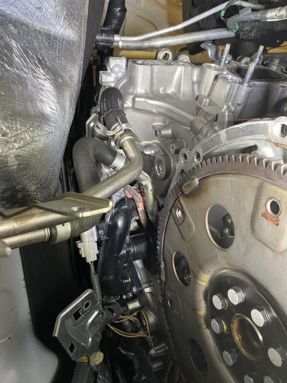

    What a PITA job… though not sure how you could do this from the top.

    They do from the top by completely removing the cab. Hint the 13 hour labor.
