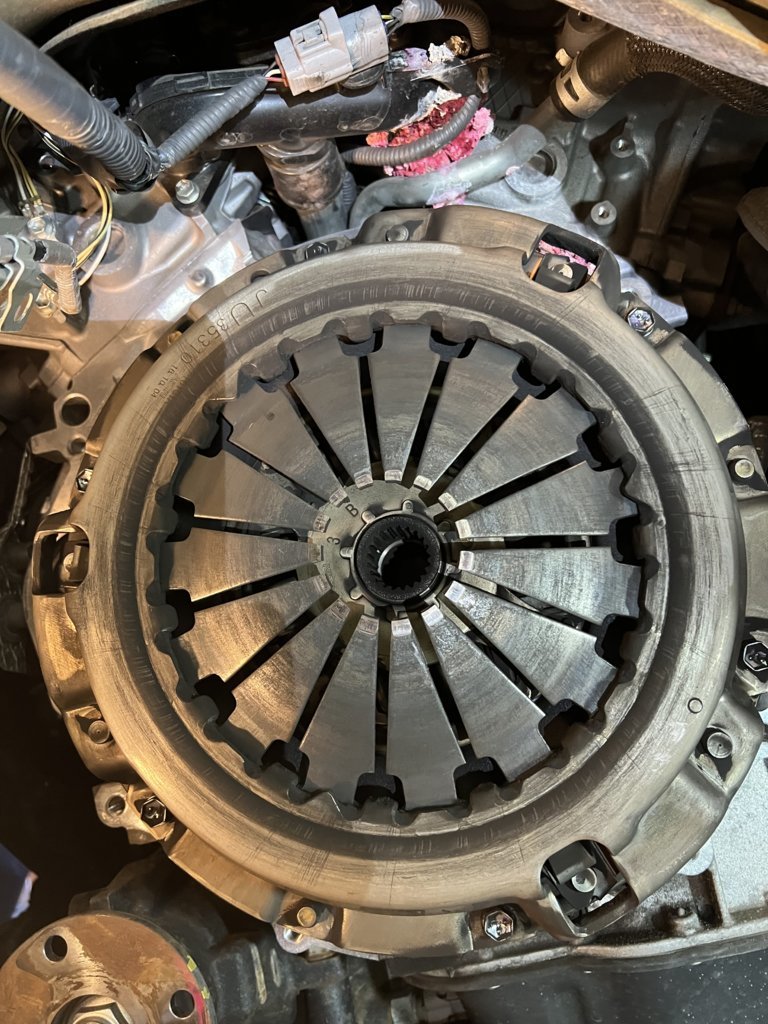

    Add me to the list. Decided to do it myself and upgrade to a Centerforce II dual friction clutch while I was down there. Got it torn apart now, new valve gets here tomorrow.

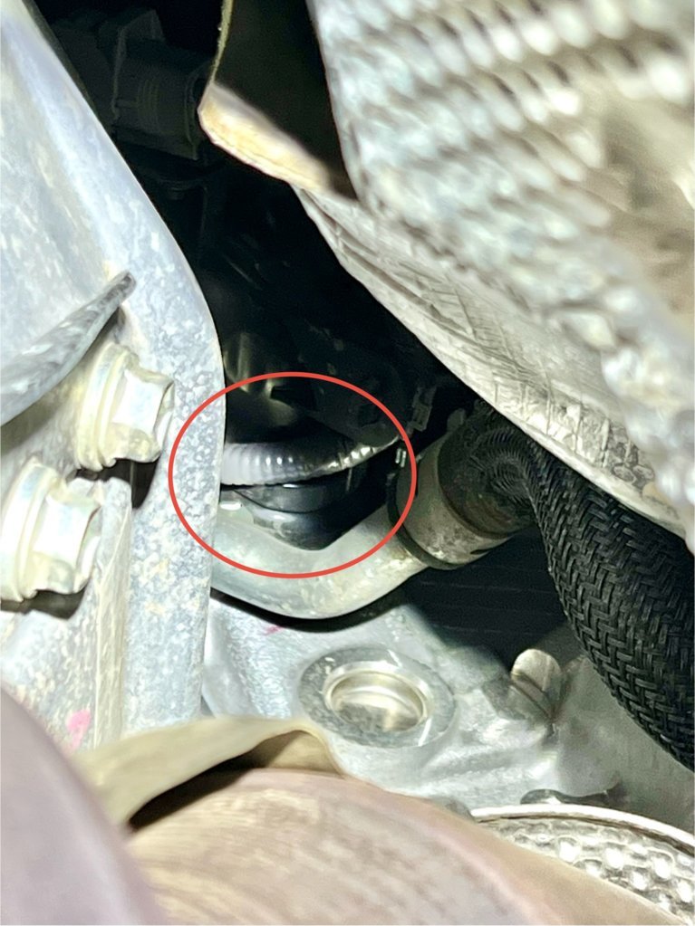

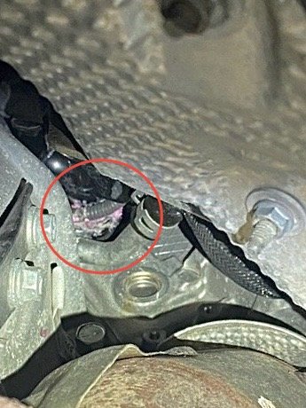

  13. Oct 31, 2024 at 11:12 AM
    #133
    poopshute
    poopshute Well-Known Member
    Jul 7, 2009
    #19385
    814
    Colorado
    2017 Tacoma TRD Pro Storm Trooper
    This post had me panicking as my stock radiator just popped a leak on my 2017 Pro with only 45k miles on it. This bypass leak is actually pretty easy to spot with a flashlight and getting under the truck. Look right above the cat on the passenger side and right above the bell housing. Stole a pic from this thread and matched it with mine. Fingers crossed mine stays leak-free. This should help folks spot if you have the leak or not without a scope or twisting your neck too much. Here are the good and bad pics taken from underneath the truck.
    Good (no leak):
    Bad (you have a leak):
    doublethebass and thomasburk like this.

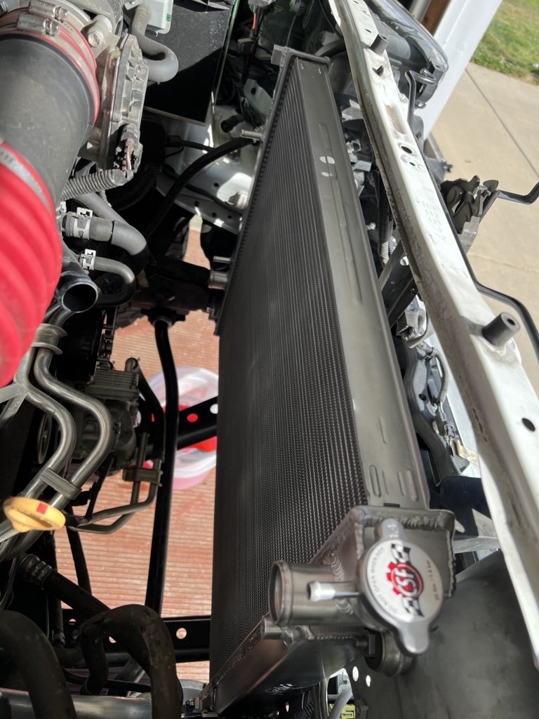

    2017 DCSB TRDOR 4x4 M/T
    Sorry to hear that, my stock radiator on my 17' blew at 72k miles as well. I swapped in a mishimoto one with all the stock hoses and I've been super happy with it. Much heavier duty than the stock one and full aluminum. Bolts right in but I had to zip-tie the top plastic protector on in favor of using the plastic clips since it's much thicker than the stock. one.
    poopshute[QUOTED] likes this.
  15. Oct 31, 2024 at 11:57 AM
    #135
    poopshute
    Jul 7, 2009
    #19385
    814
    Colorado
    Like minds! Swapped mine out with an all aluminum CSF and Mishi tubes for the bling factor. I stretched the top plastic piece on mine a bit and was able to re-use the stock pins. The CSF is quite a bit thicker than stock as well. 2-row.

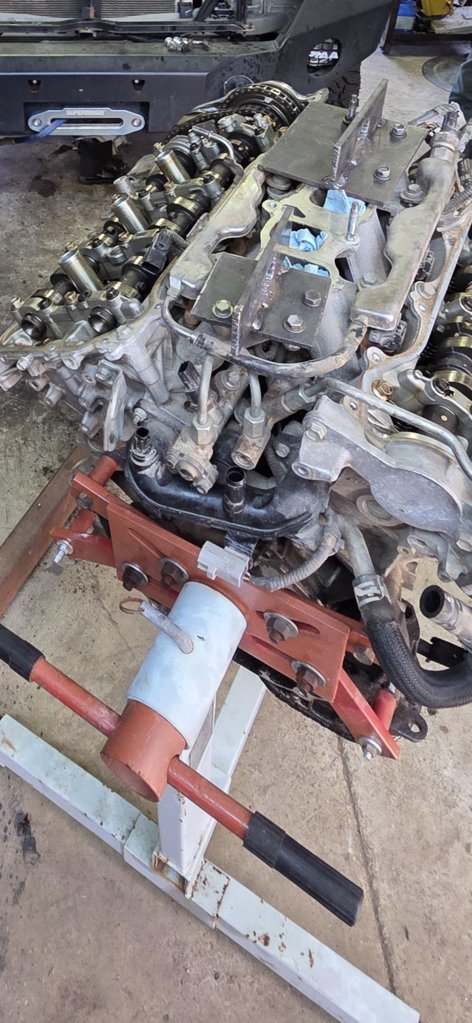

    I got lucky with my 16 OR with 220k, my bypass didn't seperate at all it atcutally held up better than the valve train did, engines totaled but the bypass joint made it lol. Plan to use a modified Lexus one when I put a new engine in.
