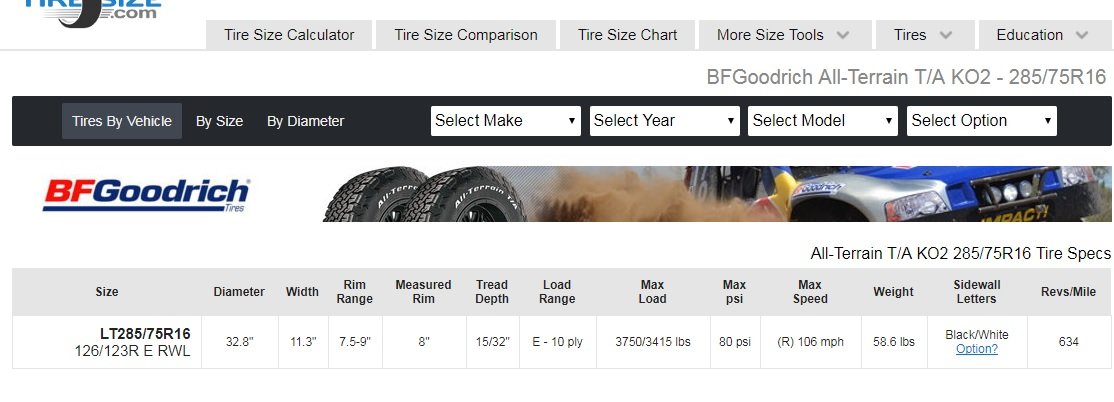

    How are you running 285 on a 7 inch wide rim? The 285/75r16 KO2's say rim size of 7.5-9". Was there any mounting issues?

    Called poor mans bead lock. People run 12.5 wide tires on 7 inch rims.

    My guy said they went on fine. They have some bulge, but it looks good IMO.

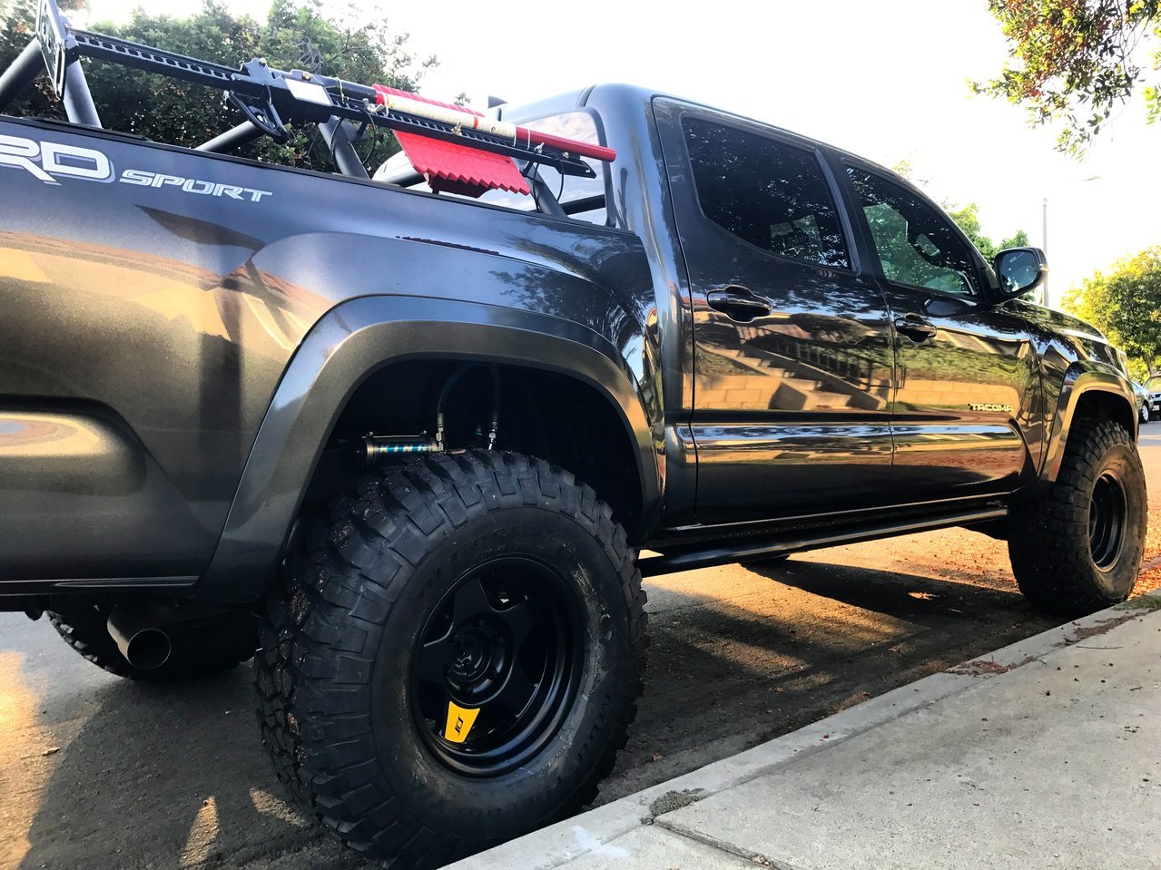

    Under normal driving conditions all is good. When about half flex I get slight rub.
    Rims are stealth custom series F5's 16x8 -25 offset
