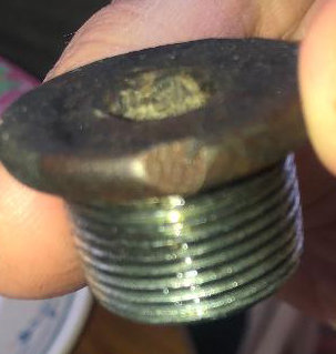

    went back to check and they had not disposed of the plug
    here it is with a notch out to get it loose
    chisel or drill and special tool to break it loose?
    went to the dealer service advisor to show him and he just shrugged his shoulders :notsure:
    I would of thought he would at least call back to the guy in charge in the shop to tell all techs to watch out for this ... customer service is JOB #1

    This is very common, they round out, even with the best of tools... I've been replacing them for a couple of years now with Lexus part number 90341-24016. It has a 14mm nut instead of the female hex. Gasket remains the same.

    is it common for them to NOT put a new one in when they notice this happening?
    I mean contact me tell me we need to charge you for a new plug this one is old
    this is my point, I understand this. it happened when I was a lubeTech in my teens.
    we always put new plug in if it looked like it was needing one, not leaving the next tech/mechanic to have a headache

    I agree, it should be changed... but difficult to say what different techs will do on different days. The part is inferior and designed to fail.
