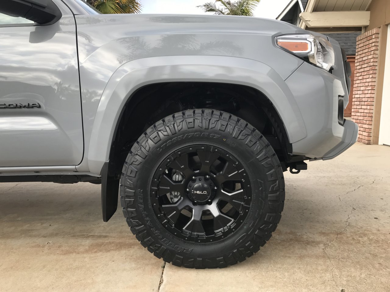

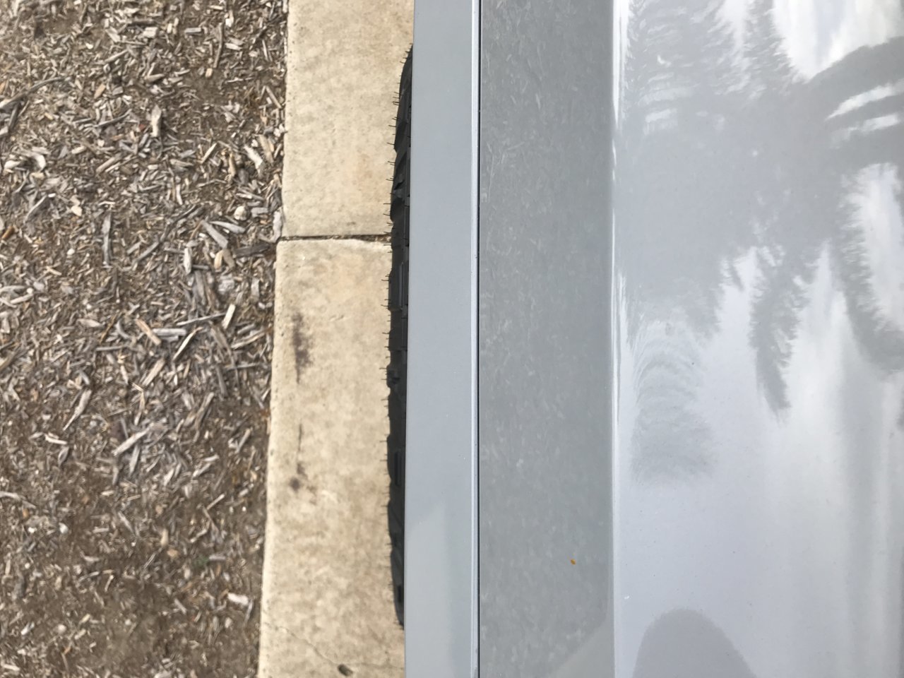

    Adding my contribution to this ongoing thread...
    2019 Tacoma TRD Sport, not 4x4, no lift.
    Helo 878 Wheels - 17x9, -12mm offset
    Nitto Ridge Grapplers Tires - 265/70r17
    Getting some rubbing on the front mud flaps on full turns — going to mod the flaps or replace with aftermarket (or remove altogether, not sure).

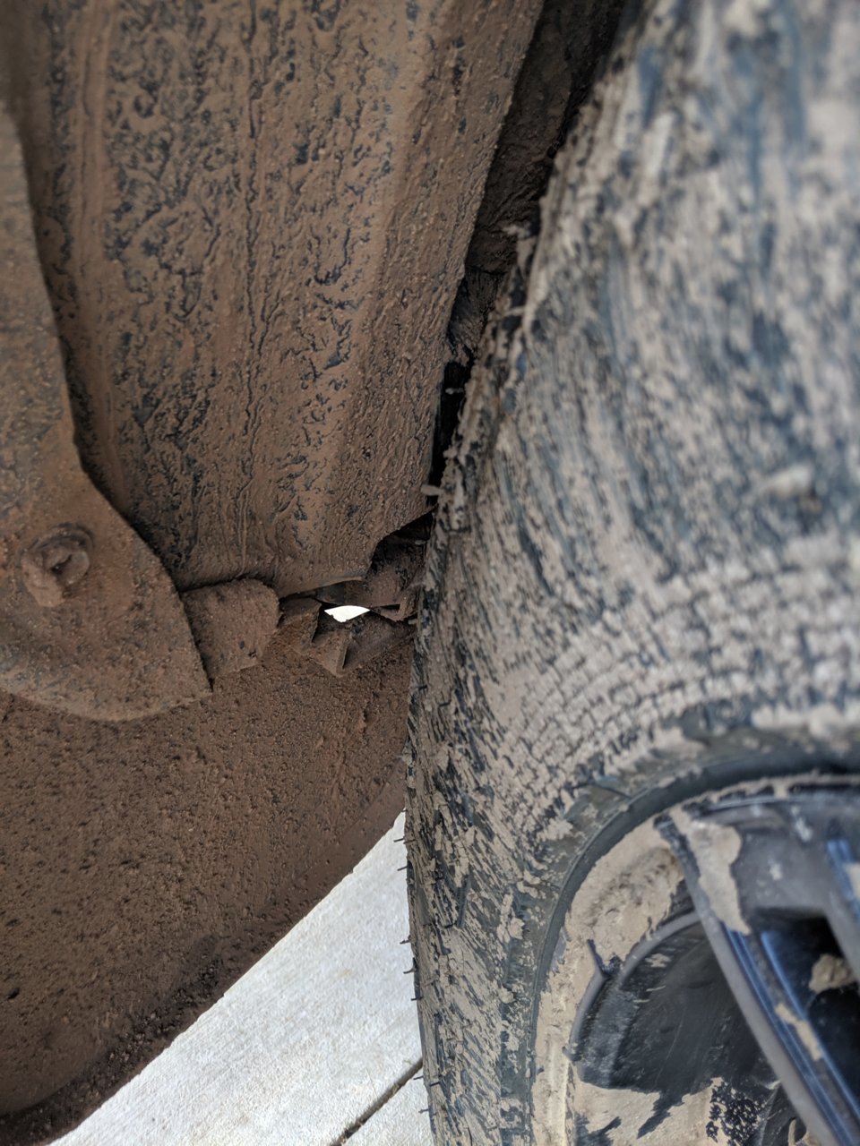

    I trimmed where my mud guards overlapped the inner fender. I cut so the bolt from the bottom still attached, then next to the lower bolt from the wheel well.
    Seems to have got almost all the rub. I spotted a small bit of clean spot in the mud from this weekend, but I gave it a pretty good workout in the mountains.
