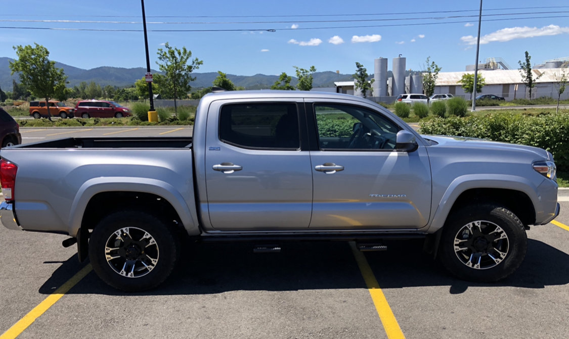

    Before a 2” lift here’s my 2017 SR5 with factory 1” lift and 265/70/17’s on Ultra Maverick 235 17x8 wheels.

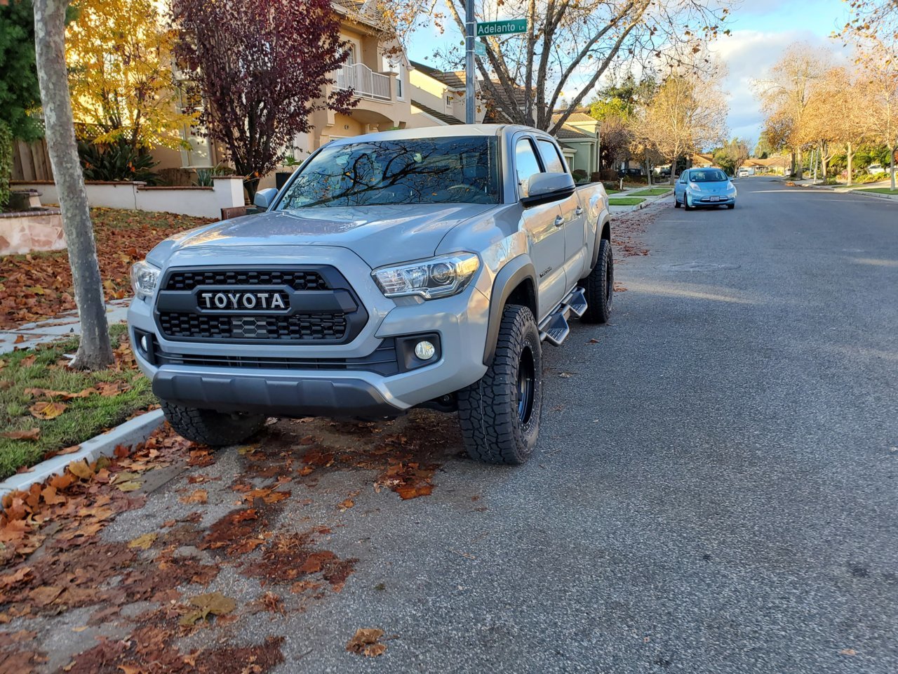

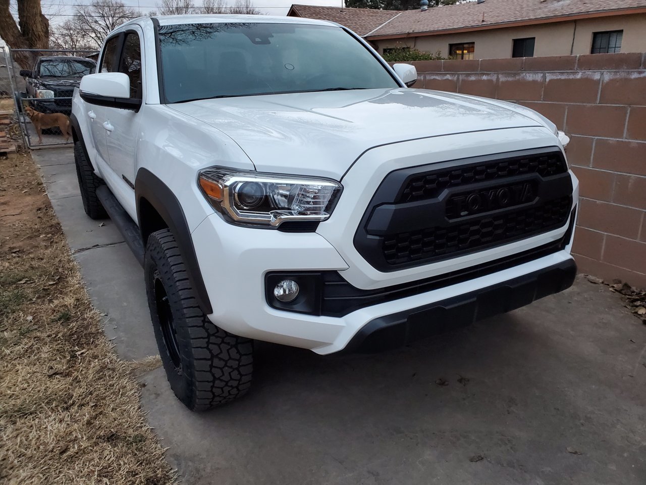

    2020 TRD OR - Stock Height
    Motegi MR149 MT6 17x8.5 +0
    BFG A/T 265/70/17
    RekGen Mud Flaps
    Had minor rubbing up front when turning in reverse. Had to do minor trimming of the front fender wells behind the mud flaps, so that they can sit more flush with the fender well. Simple process and now have zero rubbing.

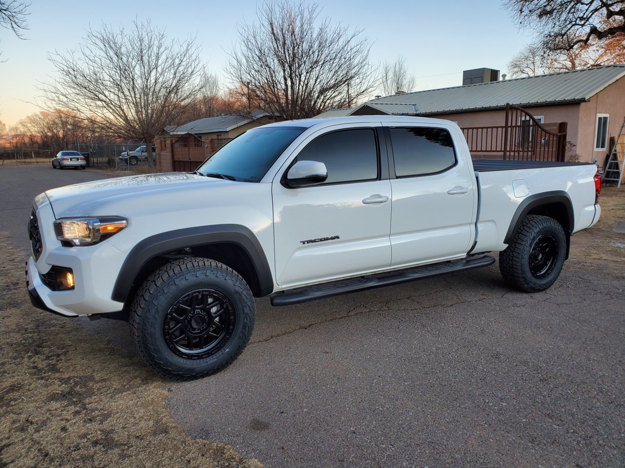

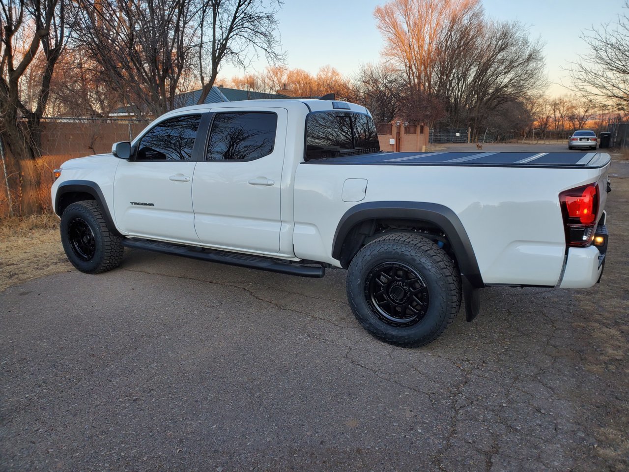

    2019 DCLB TRD-Off Road
    Falken Wildpeaks 265/70r17 with KMC Mesa 17x8.5 0 Offset. All stock suspension. Had minor rub on mudflaps, had to take them off.

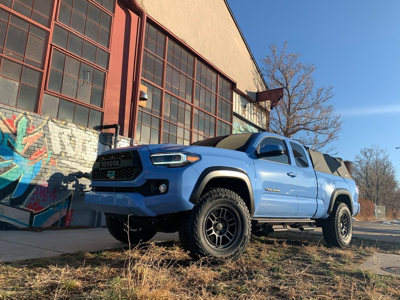

    2020 Tacoma 4x4 Sport 6MT access cab
    I did not need to heat gun, at least not yet. Just took that corner off the inside of the fender flare.

    That corner that was discussed on the video you posted?
  16. Jan 15, 2020 at 7:31 PM
    #476
    DeusExMachina
    DeusExMachina Well-Known Member
    Oct 1, 2019
    #306810
    273
    Denver, CO
    Yep. I think his part 2 is heat gunning.

    Hopefully it all just comes to this and nothing more. I might have to use a knife since I don't have a dremel or saw lol. How bad were you rubbing?
  18. Jan 15, 2020 at 7:57 PM
    #478
    toofast4u752
    toofast4u752 Well-Known Member
    Mar 22, 2018
    #248115
    58
    carlos
    2018 TRD-Sport 4X4
  19. Jan 15, 2020 at 8:04 PM
    #479
    DeusExMachina
    Oct 1, 2019
    #306810
    273
    Denver, CO
    Turning into parking lots or driveways, just a little brrrt. More annoying than anything. You can do it with a sharp utility knife, just going to take a little longer. Maybe tin snips.

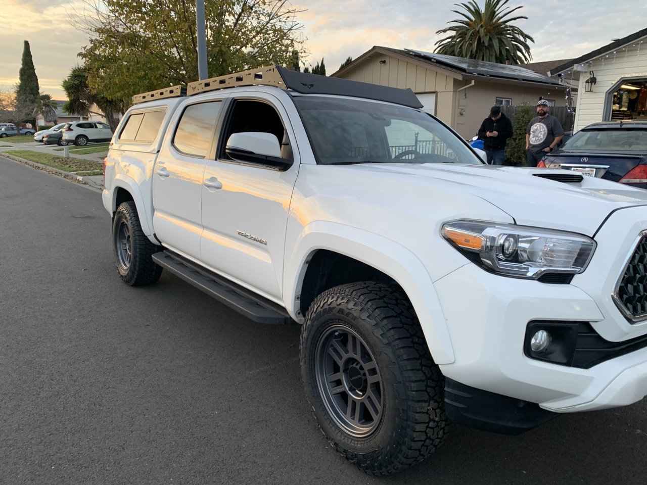

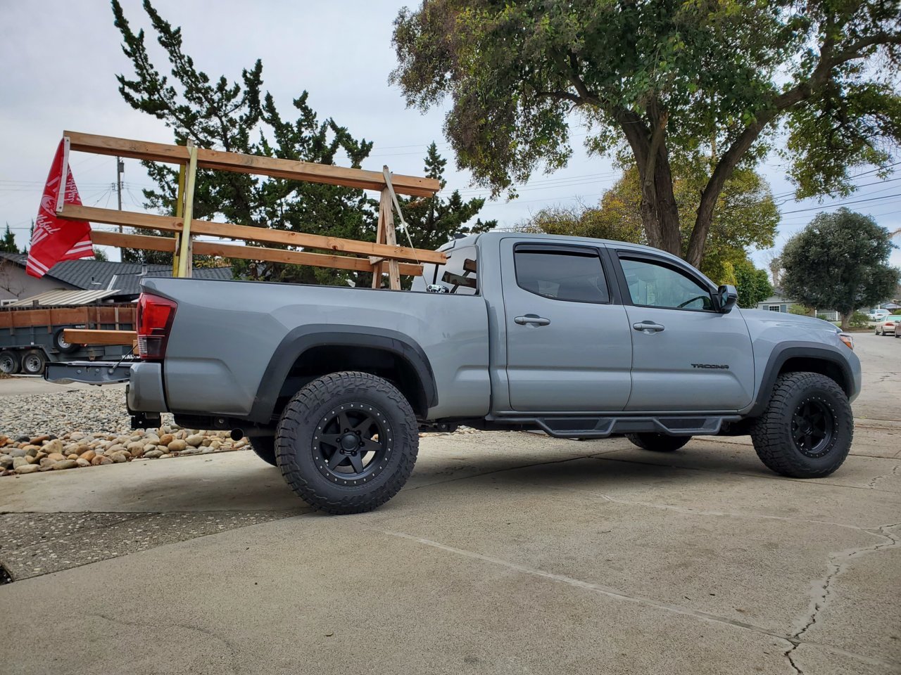

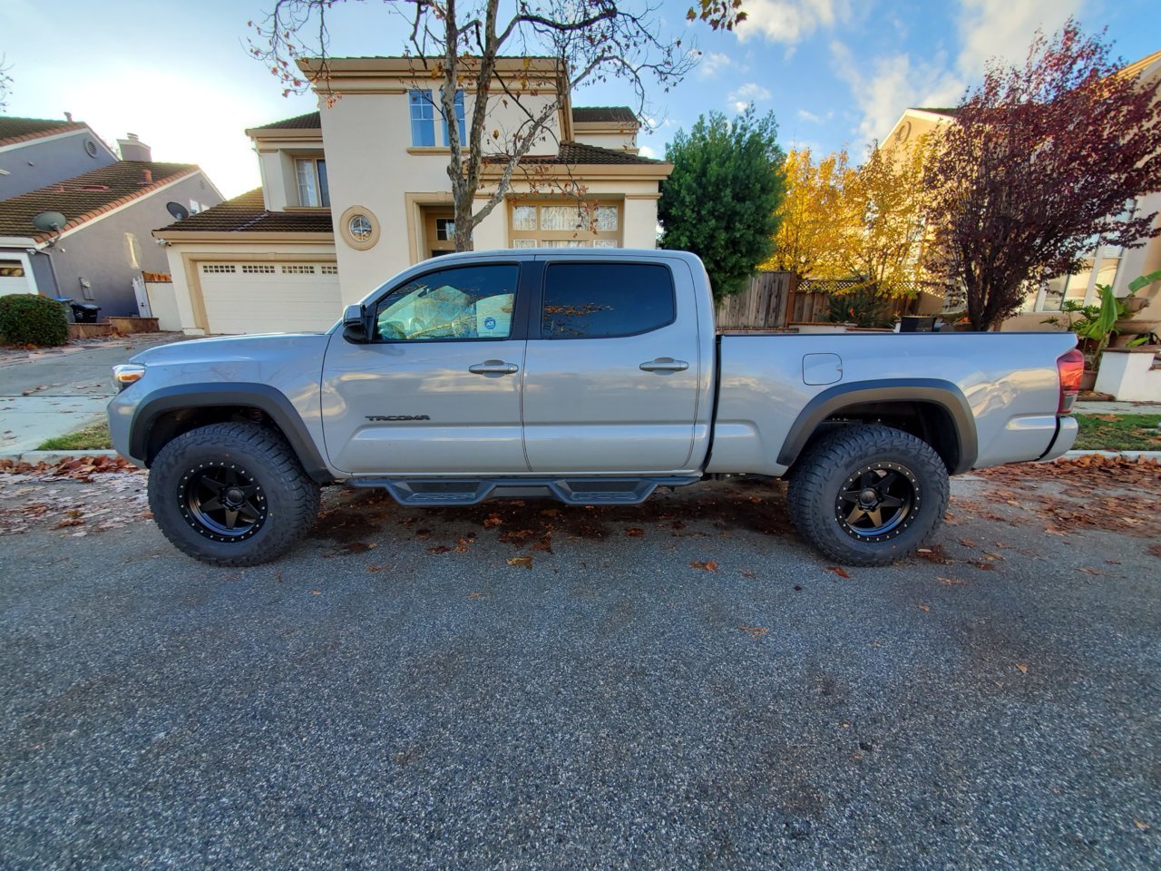

    2019 DCLB OR
    SCS BR6 17x8.5 -10mm
    275/70/17 Falken Wildpeak AT3W
    A little rubbing when I do a full turn in reverse. I've pickup materials and haul stuff without any problems.
