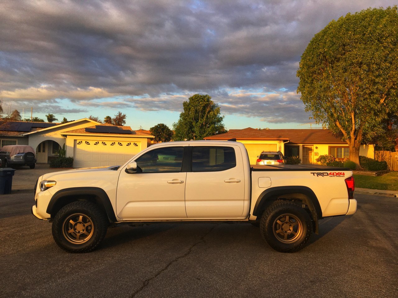

    mudflaps gone, they rub badly enough I'll need to address with 5100's or a spacer. Looking for input on best option, this is a highway warrior and I like a slight rake with the front lower. But I need clearance.

    If you've removed the mud flaps, I'd be will to bet you're rubbing on the front inner fender plastic. This area can be easily trimmed or remolded with a heat gun/hairdryer enough to eliminate the rubbing. Any trimming/molding you do will cause zero mechanical or performance issues, and can be done in a way that is not at all noticeable to the onlooker.
    My suggestions are solely based on the rubbing being on the front side, and is simply meant as an option to modifying the suspension and playing the rake game.

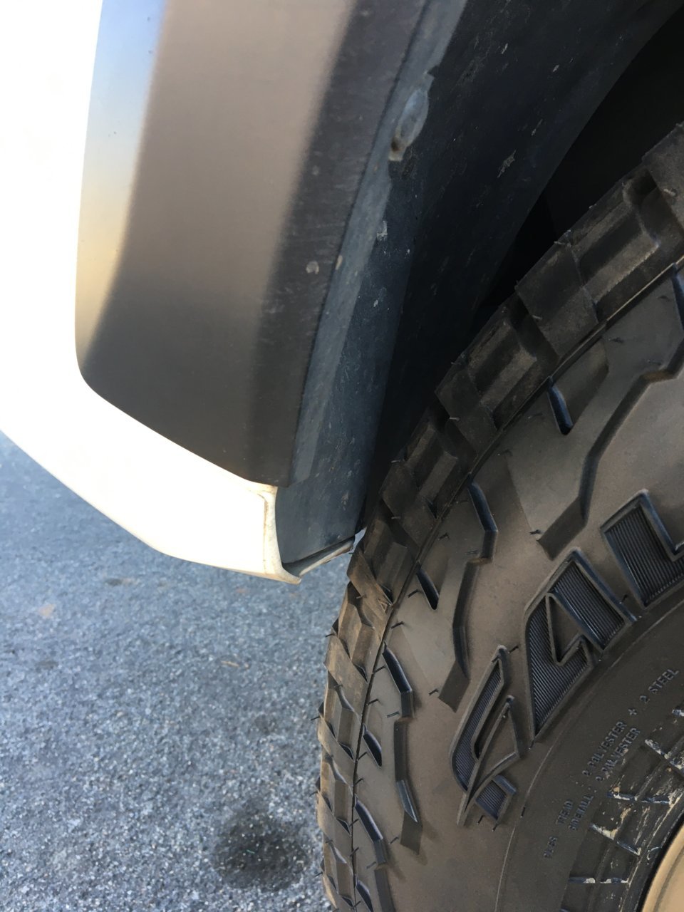

    Here's an image, its where the bumper meets the fender liner.

    Thats what I was referring to. I'd lean towards trimming/molding plastic before I started putting on lift of any kind, but its clearly your truck/your choice.
    A lift might satisfy some aesthetic desires, but there can be unforeseen hurdles produced as a result. That and a lift isn't always a guaranteed fix to rubbing.

    Thats true, I'm tempted to try out a 1/2" spacer to just bring it up slightly. I'm happy with the stock suspension, only other alternative I see is going 5100's on a low setting or changing the tires to a smaller size.

    The rubbing you're experiencing has more to do with the specs of your wheels rather than that tire size. The -10 offset has pushed the wheel/tire nearly 1.5" out of the wheel well than it was with the stock wheels. That 'stance' now puts the whole setup closer to those plastic bits and the cab mount as you turn and encounter off-camber situations. A lift will help, but I'd be willing to gamble you'll still rub in certain scenarios. Less often though.
