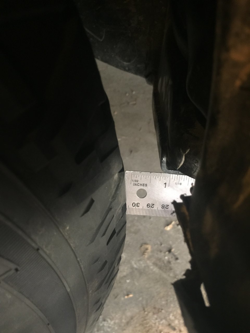

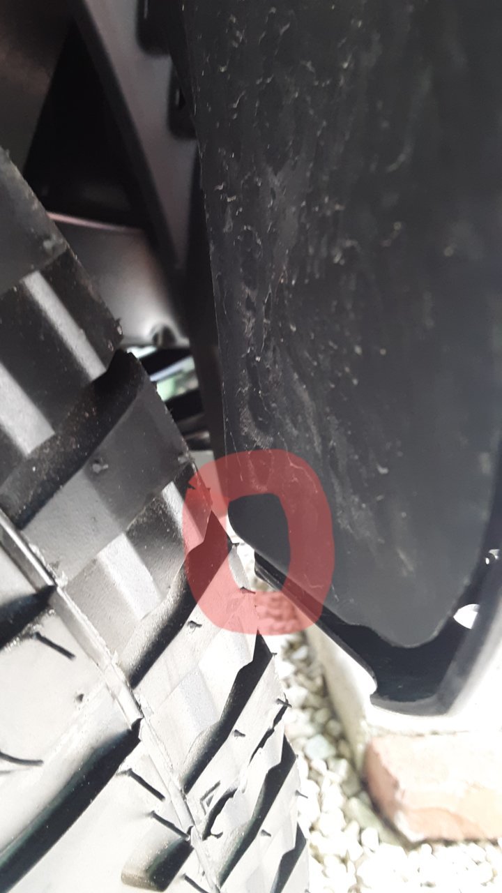

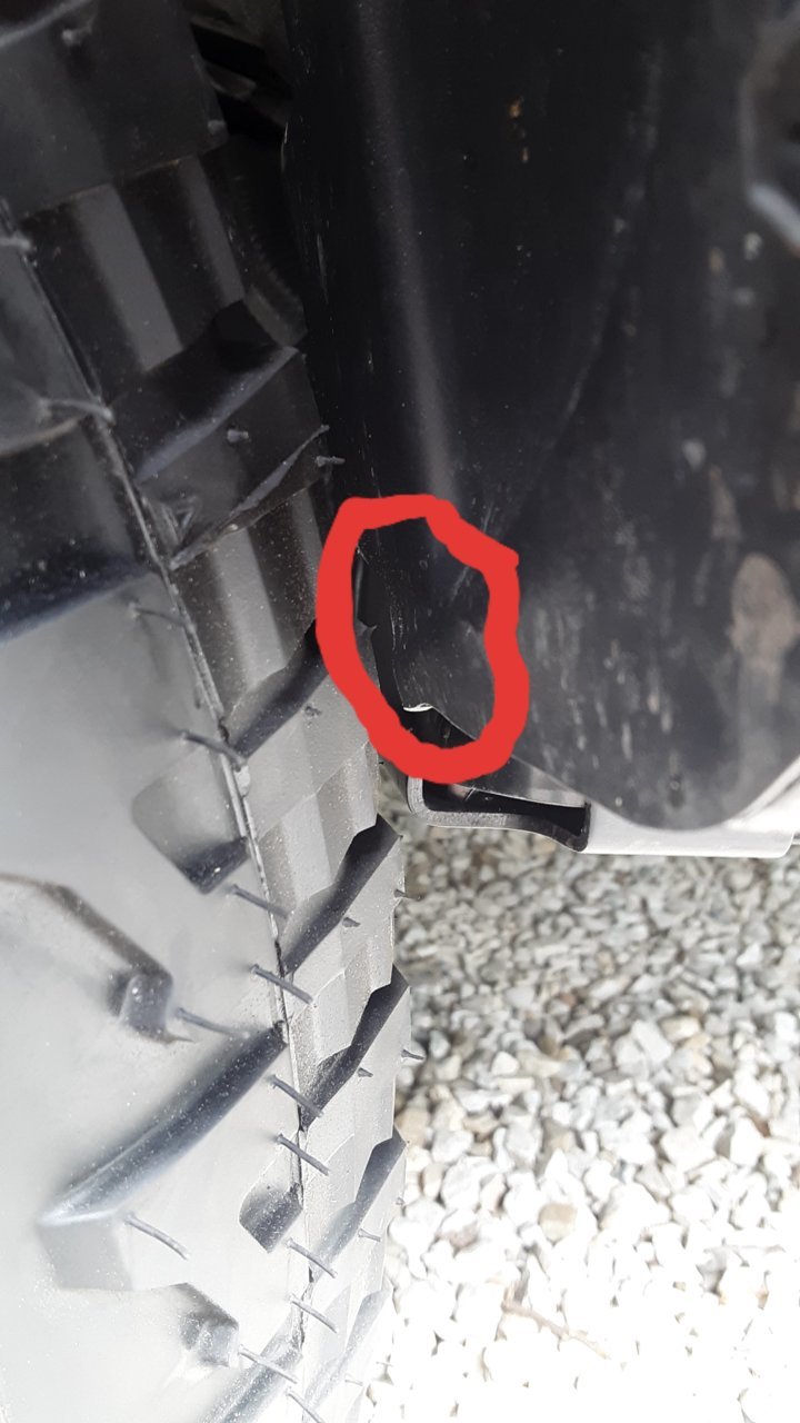

    I didn't do any cutting or trimming. I had to heat and mold the fender liners in the front near the bumper and the rear near the pinch weld. I dont have pictures of how it ended up, but it's not noticeably deformed by any means. I heated, molded just a bit, then drove it until I encountered another rub -- then repeat.
    I Used the tire Mark's as a indicator of what to heat and mold. Here are the areas it rubbed.
    Front bumper liner passenger side
    Rear pinch weld liner driver side.
    I also wound up heating and molding the liner on the drivers side where it attaches to the front bumper.
    I thought about doing this (pic below is a trimmed front bumper) but honestly I didnt want to push the liner that far out of factory position. I just got it nice and hot and molded it into a better spot to allow for clearance. Like I said a little at a time then test.

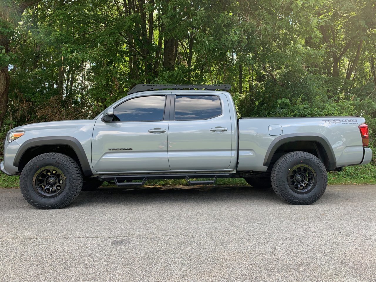

    265s, AEV, no lift.
