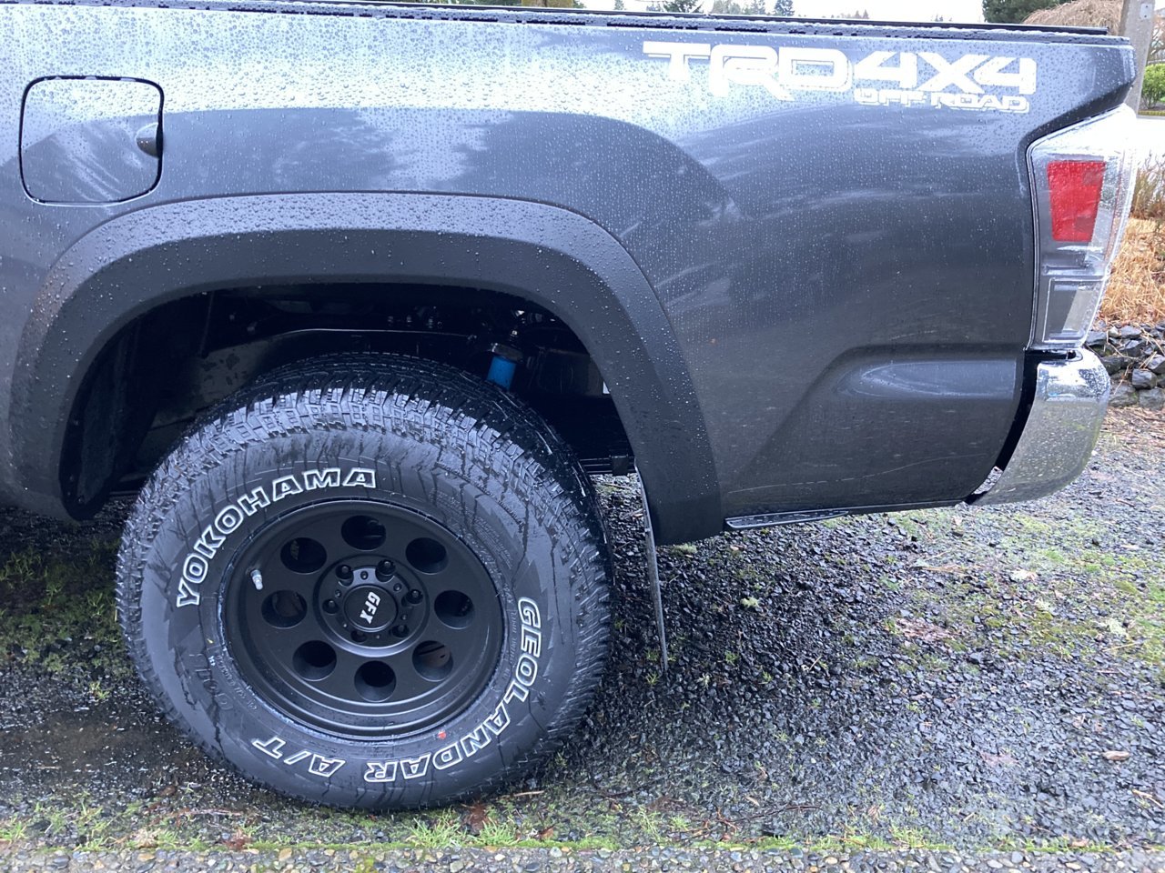

    Hi Guys, I am new to the forum. I have a 2017 Taco 4x4 Off Road, and wanted to make it look a little more aggressive. I have looked at some of the off roading videos on Youtube, and to tell you guys the truth... I just ran outside and hug my truck, and told her, I will not be putting her through that. Even though it is cool as hell. Anyway, I bought my truck specifically for hunting in Michigan. I do take it on dirt road and mud fields. I wanted to put some 16 x 8.5 wheels with 265 75R16 LT tires on the truck. I just bought the rims, but the off set is -6, will this cause rubbing? I have not picked up the rims, but I am not sure if they will work. The brand is GFX TR16, thanks.

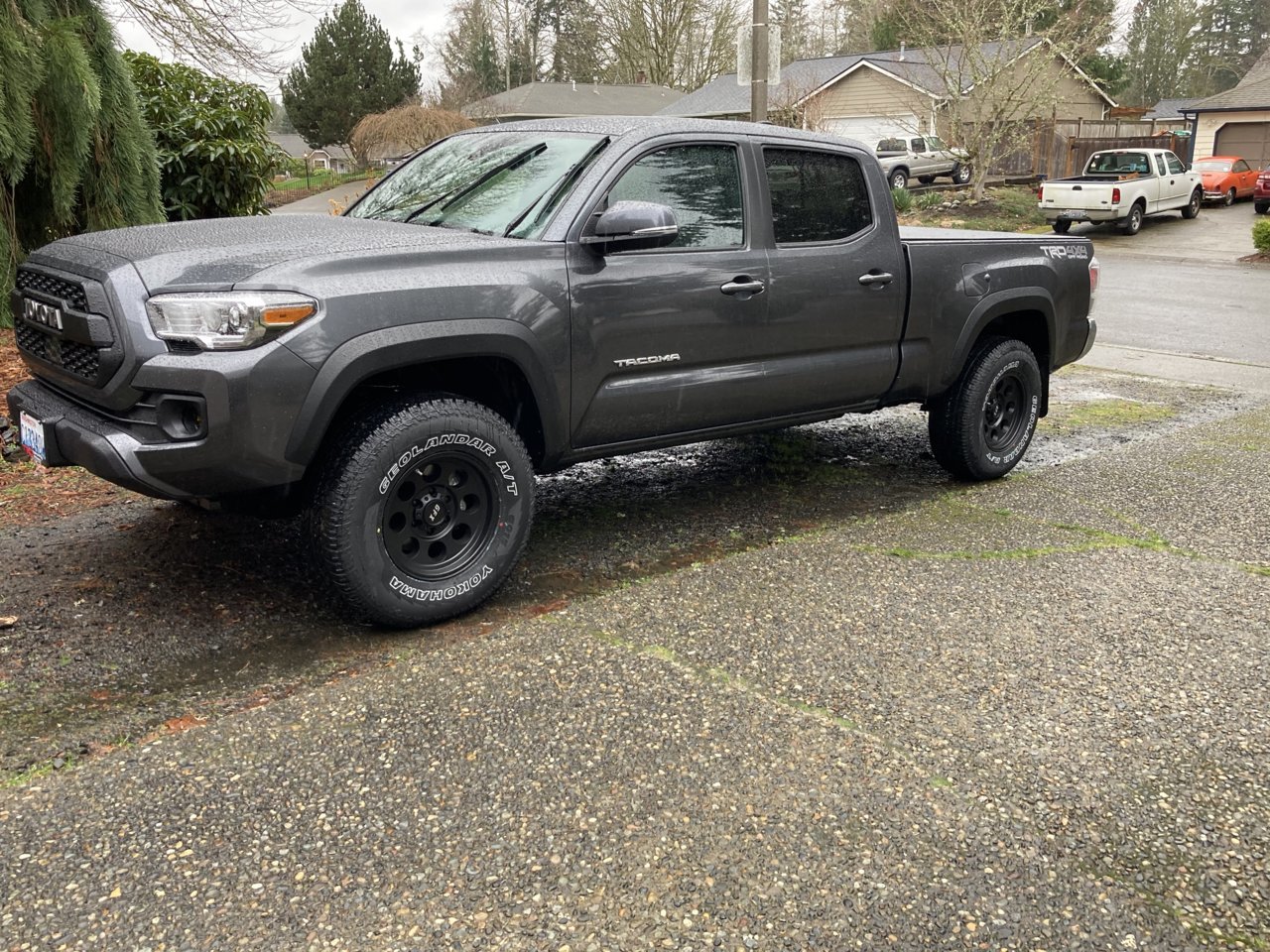

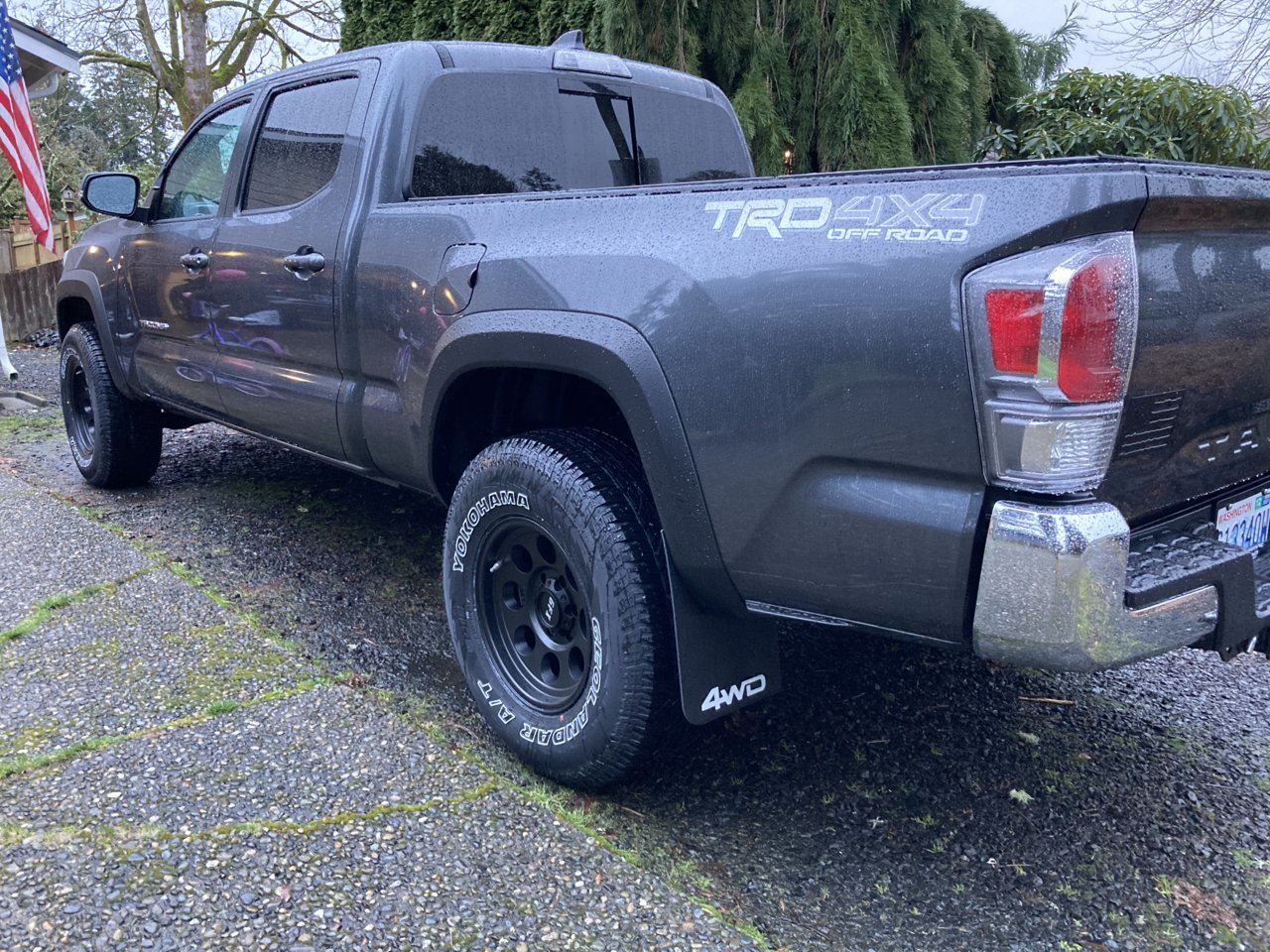

    101530C3-A925-4B35-8973-9246CED33B14.jpg I just put these wheels along with 265/75r16 Yokohama G015’s on yesterday.
    Very very minimal rub when turning and going up a bump at the same time. I took a heat gun to the fender liners as soon as I got home and all is good.

    Which wheels are those?

    G-FX TR16 made by Voxx. Got them at Discount Tires.

    Thought Pro's were a 17 inch wheel?

    Tacoma Pro is 16” and 4Runner Pro is 17” the last time I checked.

    no, the real tacoma pros are 16”
    The knock offs are 17”
    The 4 runner pros are 17”

    i like those wheels

    and i really like the tires too, been looking at those same wheels at DT but in the polished silver look
    how do you like those tires? white letters out always looks sharp.
    nice job!

    I love them.
    Have only had these SL’s for 200 miles but so far so good. We ran these same tires, but in E load, on a Dodge Ram 2500 Cummins for 55k miles and had no issues whatsoever. They’re excellent in the rain and slush/snow, are quiet and smooth, and do well on hunting roads and light off-road trails.

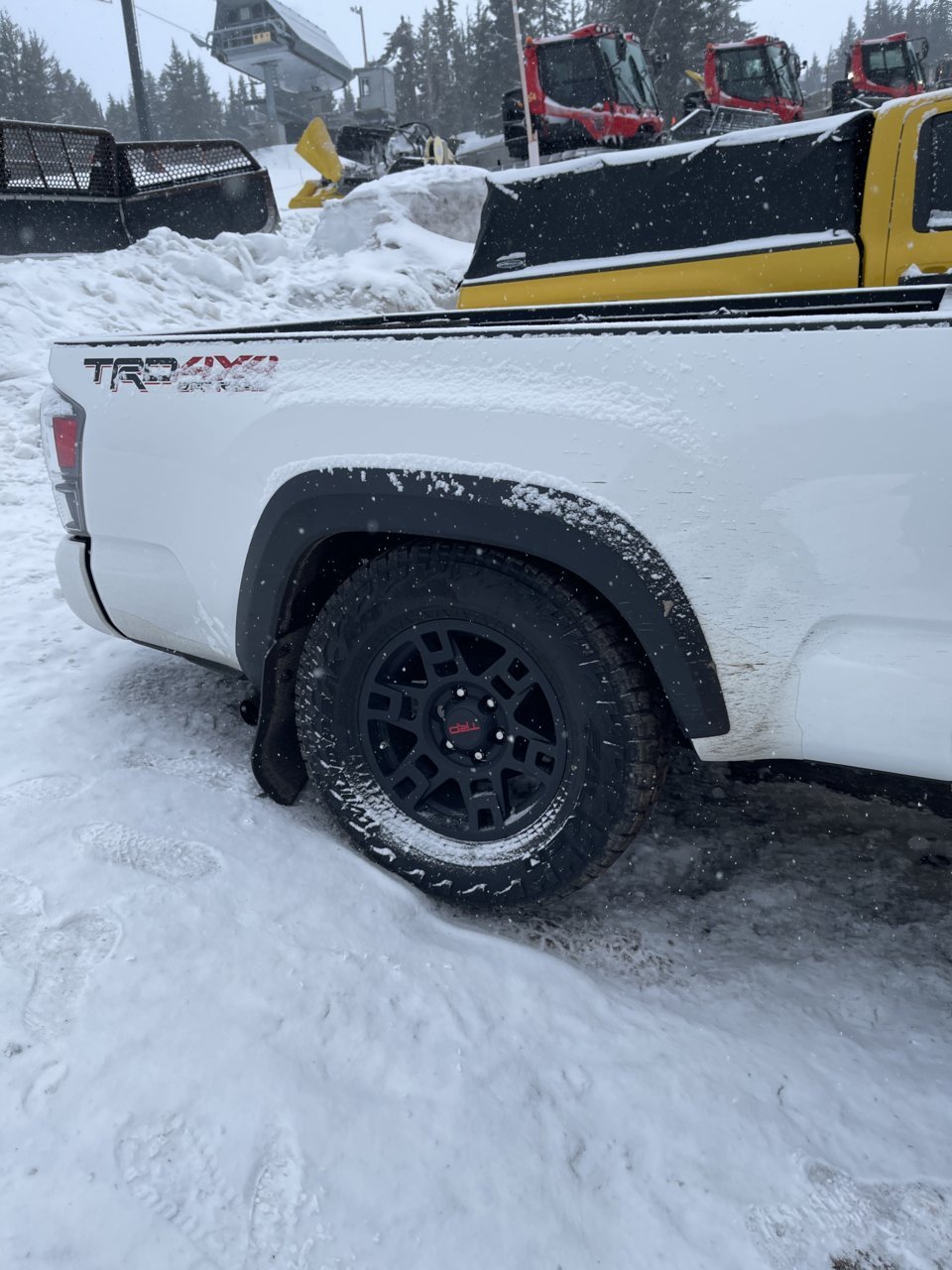

    Mall crawling at the ski resort today
    265/70/17

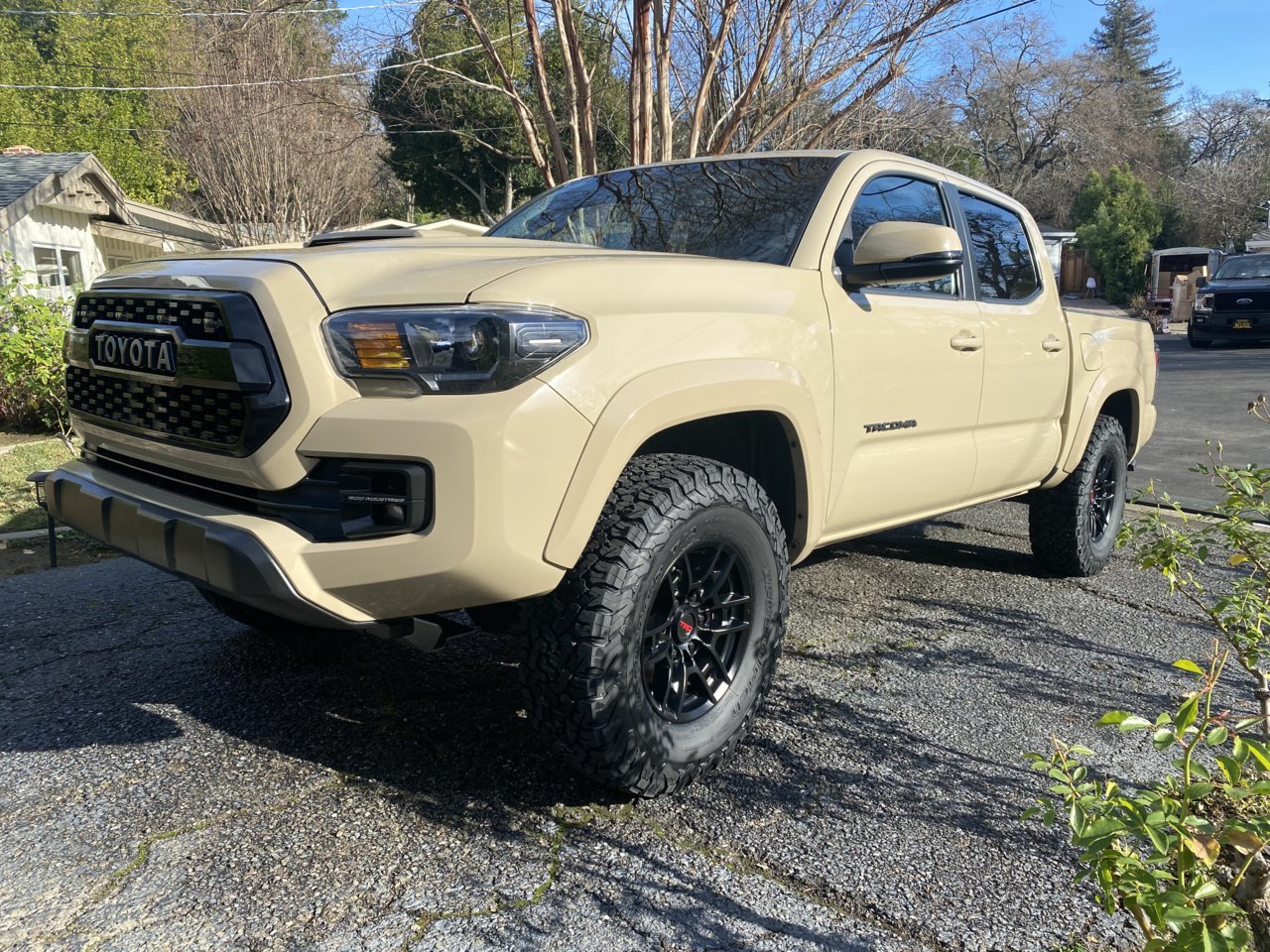

    No lift, no level.
    17x9.5 -18
    265/65/17

    CMC?

    Nope.:thumbsup:

    NICE! I got some rims -12. I can't wait for winter to be over with lol.

    Should be fine with -12, so long as you keep the tire size modest.
