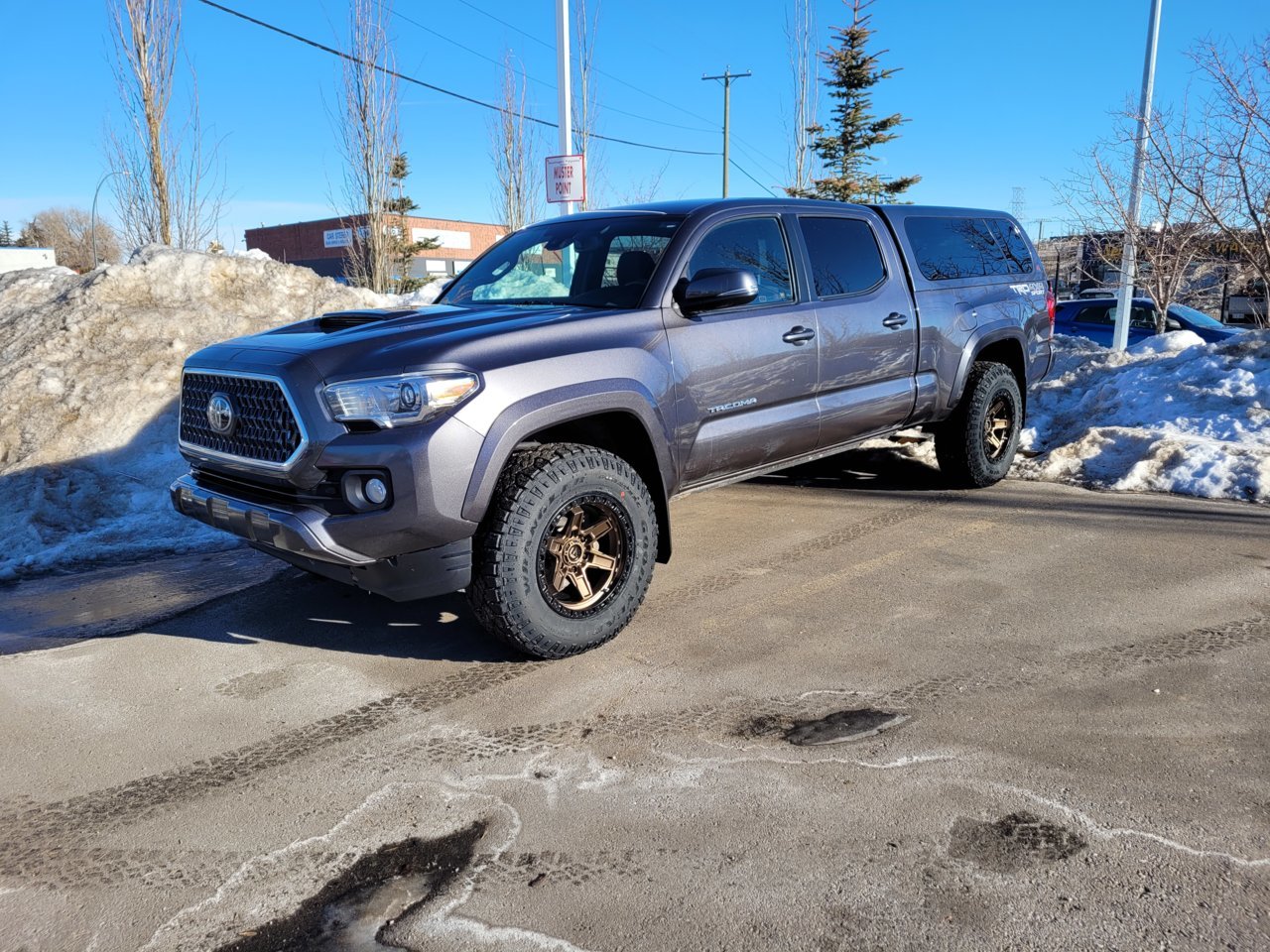

    I had to dig well into the archives for that one.
    17x9 +1 fuel kicker
    265/70r17 duratrac

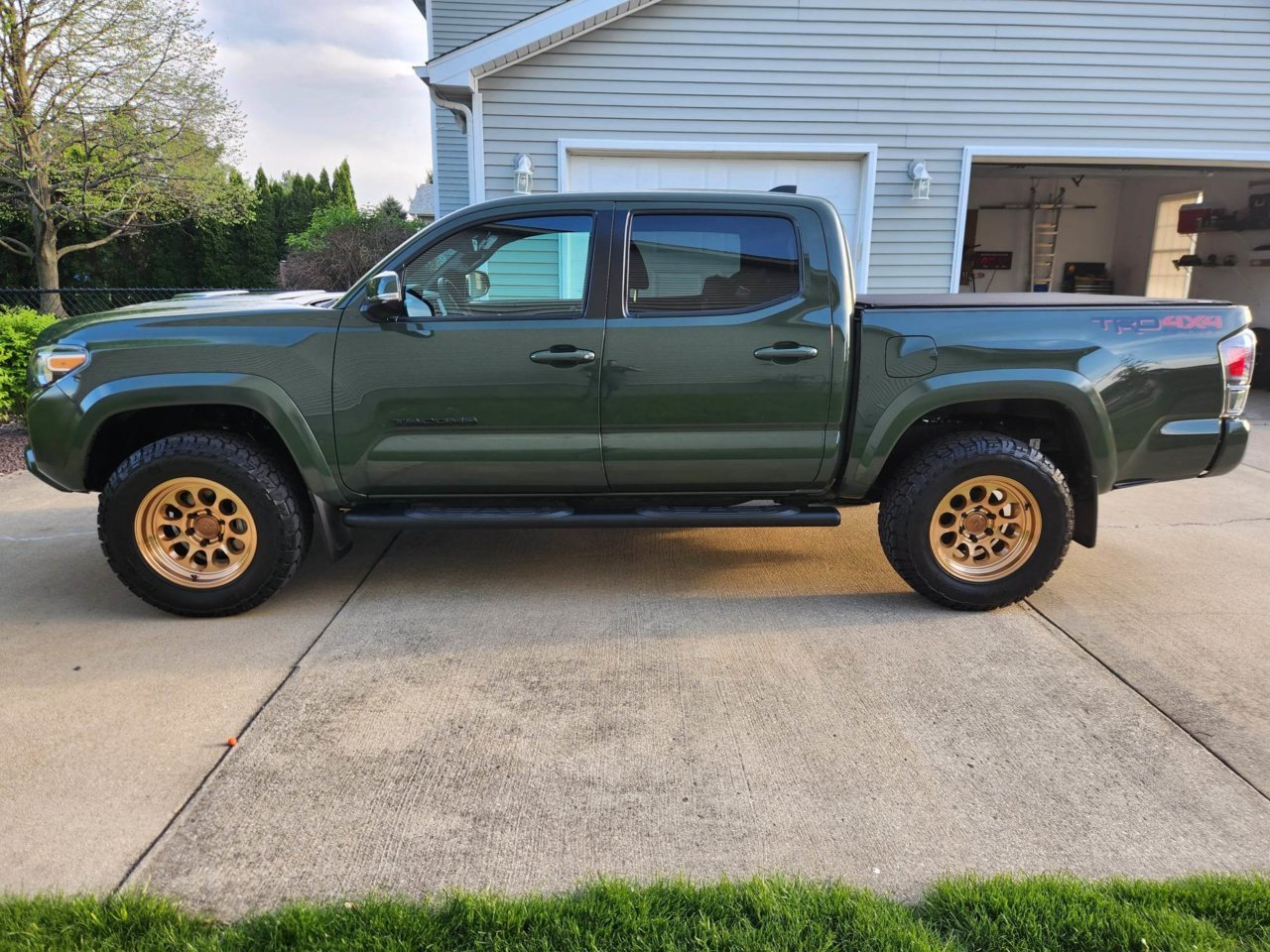

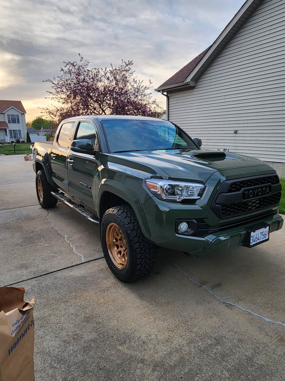

    SCS Brushed Copper 17x8.5 -10 OS with 265/65/r17 General Grabber ATX tires!

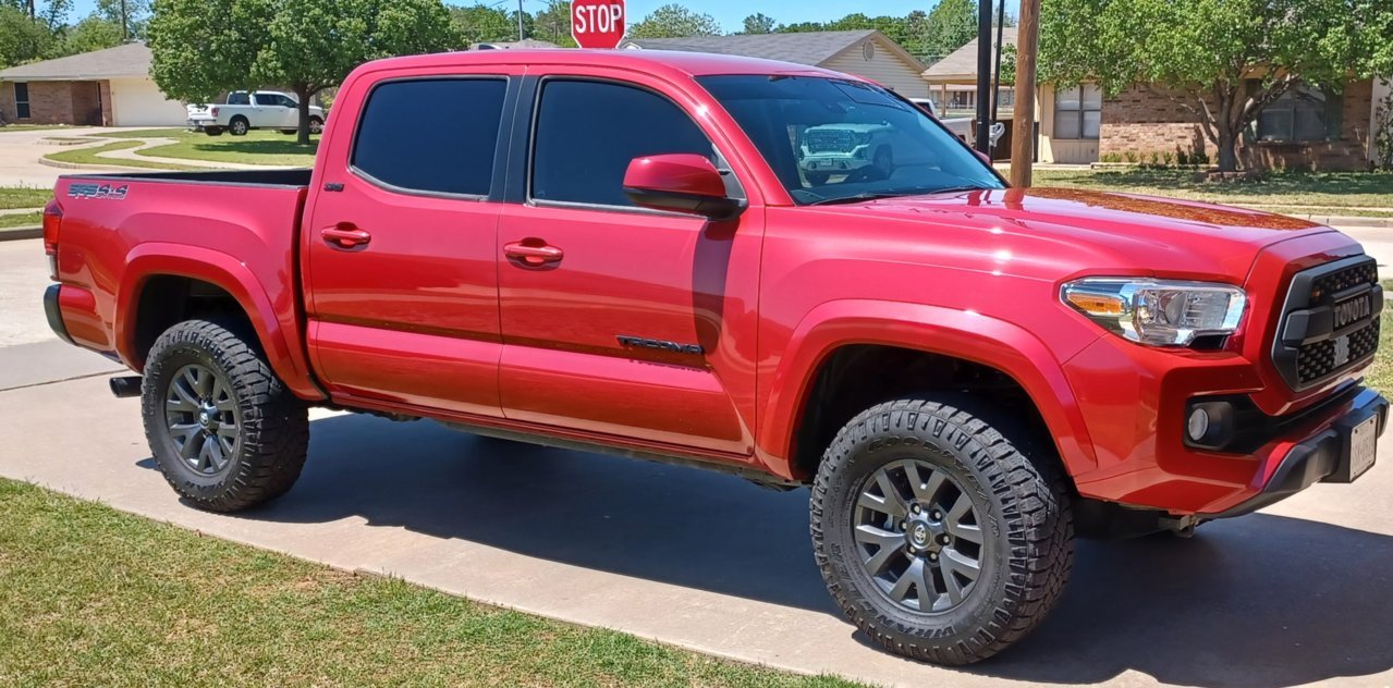

    2021 SR5, Barcelona red, v6, 4x4, double cab.
    goodyear wrangler duratrac 265/70/16
