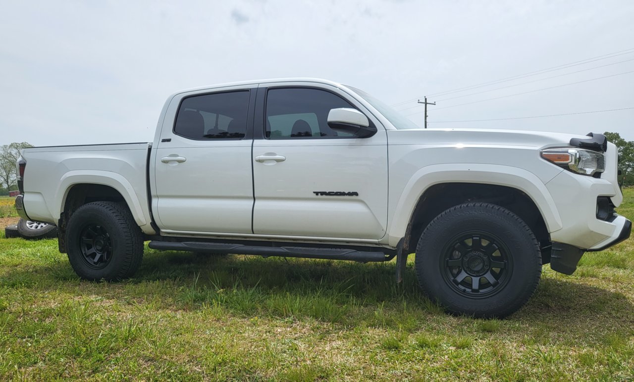

    A little late on this, but your truck looks good! I was curious if you like the Yokohamas? They're on my list of possibilities. I can't tell for sure, but are they 265/75/16?

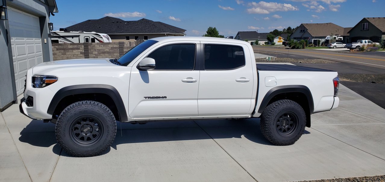

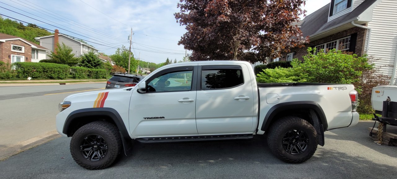

    Fast HD Recons with Falken Wildpeaks. No lift and tires are 265-70-r16. A little offset goes a long way in changing the stance of your truck and the overall look. Dont feel i need a lift at this time. OEM offset was +25mm, my Recons are +10mm.this gave me almost an inch of poke over oem wheels.20230613_164655.jpg

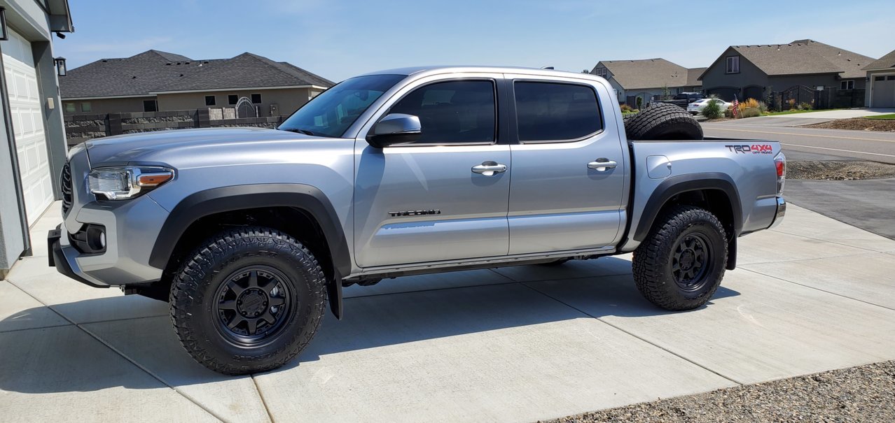

    Yes they're the same size as stock just a lot beefier, little road noise for an all terrain but not to bad.

    '24 SR6-MT DCSB
    1)265-70R17
    2)265-75R16
    3)265-70R17
    4)265-75R16
