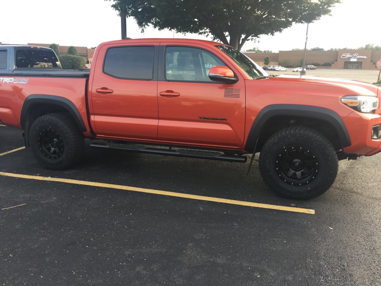

    265/75r16
    265/70r17
    Or for some, pizza cutters on stock spec rims.
    **Examples of all in prior posts on this thread**

    Is this without cutting or any other modifications?
  13. Oct 30, 2018 at 8:57 AM
    #113
    InfernoFisher
    InfernoFisher Member
    Jul 24, 2017
    #224918
    19
    Ohio
    2016 DCSB OR Inferno
    Rokblokz Husky Mats Blade LED Tailgate Bar Bed Rail Fishing Rod Holders PlastDip Rims Shift Sense Pro
    Yes
    I run 265/75/16, no lift

    2 weeks and 2000 miles in.
    Pros: wet/dry/mud/pavement traction is great. Cost less than BFGs . Aggressive sidewall design. I would purchase again.
    Cons: A bit more tire noise at highway speed, and they seemed difficult to balance. I took them back for a second balance after install (quite a bit of weights on rim)

    Not rubbing on the front flaps at full turn?
  19. Oct 30, 2018 at 12:30 PM
    #119
    InfernoFisher
    Jul 24, 2017
    #224918
    19
    Ohio

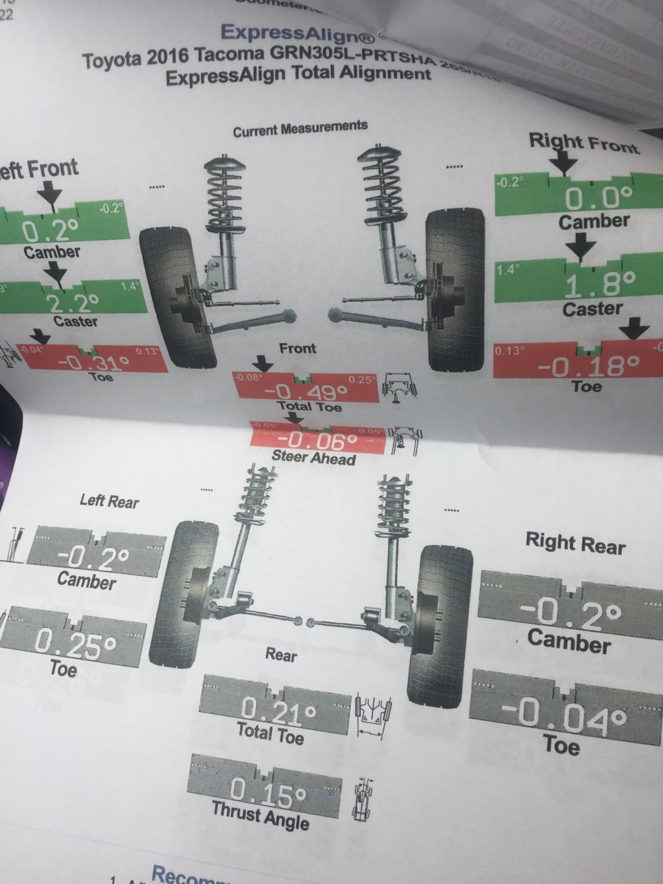

    I experienced some rub on the passenger front of the wheel liner actually when first installed but only when carrying a load and 3 passengers while turning about 3/4. This happened when entering an uneven ground/pavement (driveway, off pavement, etc). This was before I had an alignment completed (the “Toe” on each front tire was out of spec). I have not experienced since alignment. The flaps are Rokblokz and do not stick out into wheel well like others I have seen. I do see that others have posted that they experience rubbing with this tire size on stock suspension, but with a proper alignment this hasn’t been my experience.
