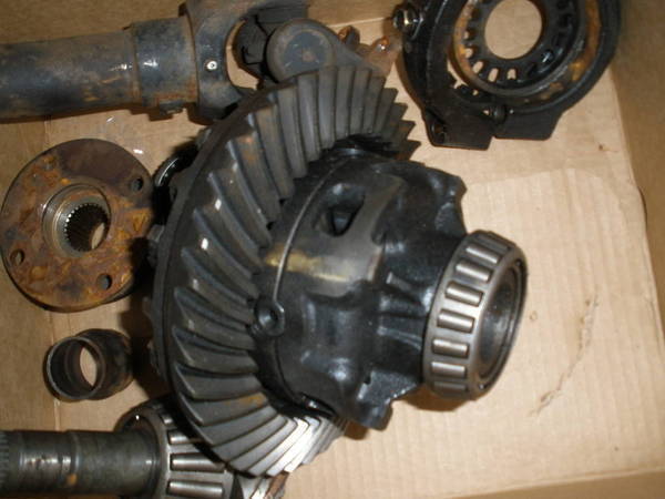

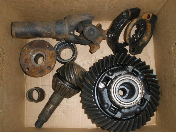

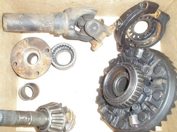

    I found a 4.10 almost complete 3rd. Only thing is it doesnt have the bell housing, just the 3rd guts
    I run 255/75/17 guard dogs. Would it be worth it to build the 4.10? Or stick with the uniqueness of running a 3.9 Tundra 3rd with LSD?

    Im not sure about the carrier on the 4.10s the guy couldnt remember if it was e locker or not. Plus I wouldnt want to bother with that kind of swap. I'd just leave it non functional. If thats even possible to use the offroad carrier in a t100 without mods.

    Im pretty sure that is a open diff but not positive.

    I do think that's an elocker FWIW though. minus the shift fork and actuator

    Thats my thoughts. If it was just a diff swap, I would probably try it for a compairson in mpgs. Maybe I'll build it just to learn how.
    Yeah I was looking for the shift fork but didnt know if it was inside the carrier or not.
