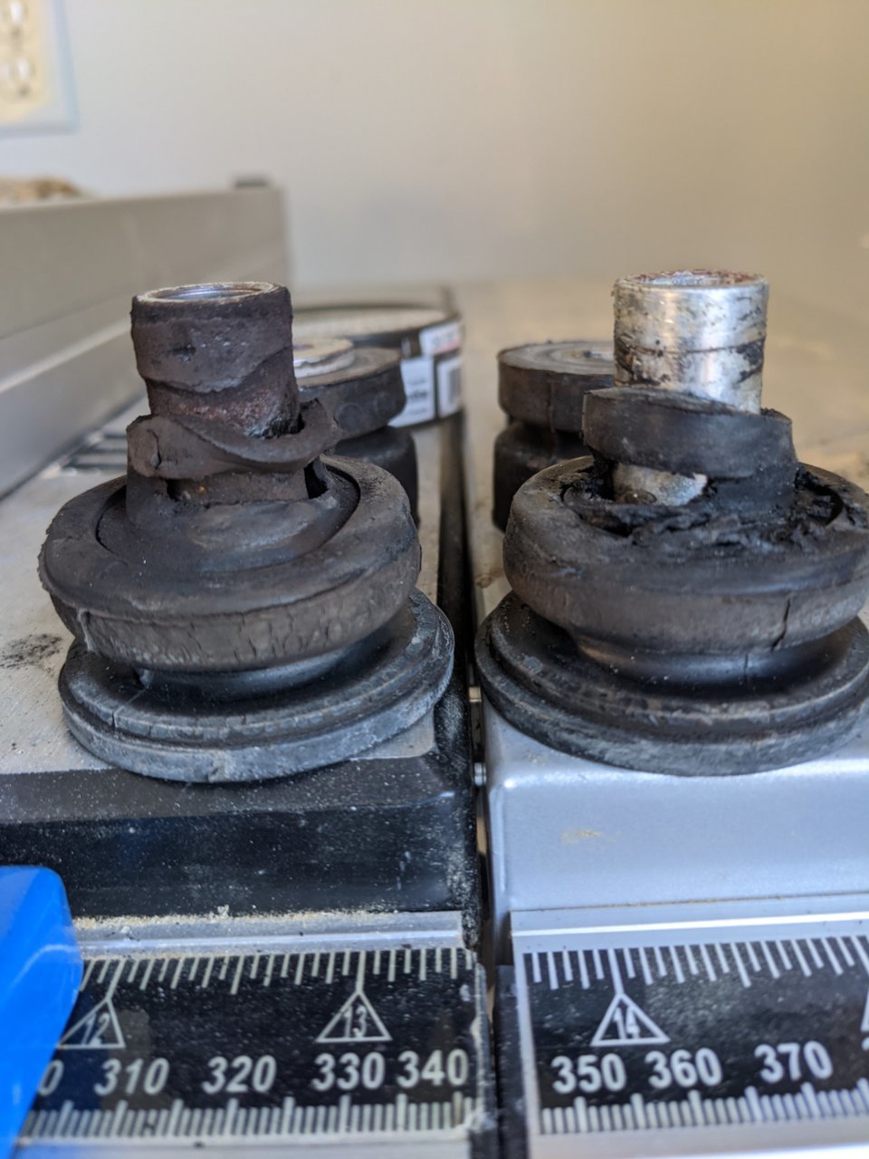

    I used the 2nd gen kit. It has been fine. I did not want to deal with adjusting the body gaps.

    I had read some people that used the universal mounts had to adjust the hood, or hood latch or something. Apparently they aren't the same height as the factory pieces.

    Is it the washer that's causing the metal to metal clunk? If so, why not use a non metallic washer. Just thinking out of the box.

    Have installed my bushing, passenger side went in like a breeze, driver side was Hella misaligned. Had to winch the body backwards to align with the frame. Though I still get those squeeks

    Thanks to another member on here for suggesting the body mounts, after describing my noise, pointed to this as possibly being the metallic clunk I hear over sharp bumps on my 2020 TRD Pro with 19,000 miles on it.
    It's going in Friday for a different issue and I had mentioned this clunk, thinking it was a control arm or suspension issue.
    Thanks for that video! I'm now almost certain this is it and will make them check.

    They heard the noise and replaced the body mounts after removing one and seeing it was worn.
    BUT, it did not cure the noise.
    Same rattle is present.
    Now the dealer claims it's 'normal noise for off road shocks'. I called FOX and they said their assemblies should not under any circumstances be rattling, thumping or clunking.
    FOX pointed me to a service bulletin from Toyota to dealers about the 19-20 TRD Pro 4Runners that use a similar Fox shock assembly up front and have the EXACT same rattle.
    For those trucks Toyota has ordered that both front shock assemblies be replaced to fix it with a TSB.
    TSB https://static.nhtsa.gov/odi/tsbs/2020/MC-10181779-9999.pdf
    So far I can't even get the service manager to email or call me back so we'll see where it goes. I sent them the TSB to prove Toyota knows those years of Pros have issues with the exact noise I'm hearing.
