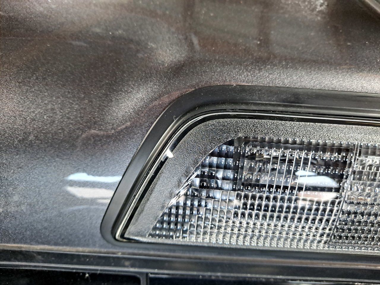

    The third brake light is bolted in from inside the cab. (It's under the headliner). Not sure how/why they discovered it was broken unless they pulled down the headliner to inspect for water damage. Many of the third brake lights were over torqued from the assembly line and cracked or broken.
    The third brake light retails for around $150, but you can find it cheaper elsewhere online. You can also find the trim ring that goes around the third brake light online.
    Do a search on the forums for third brake light leak. There's tons of info...

    I reached out to Toyota Corporate and they said they would open a claim and speak with the dealership. A manager at the dealership gave me a call and said that the stud is not part of the service campaign he was pretty rude. Probably upset that I’m trying to fight this rather than pay $848. I basically said I will work with corporate rather then give him any of my money.
    I just checked to see for myself if the light was loose and it was very loose. You can practically pull off the whole light from the left side. I checked behind the seats and also so noticeable signs of water damage. The dealership could say well the leak came from the stud being broken. I’m pretty much in a predicament now because the leak could have happened from two different sources with only one being covered in this service campaign.
    I’ll give Toyota Corp a call tomorrow and let them know my findings. I hope they do the right thing and offer to replace the light assembly free of charge. If not I don’t think I’ll be buying another truck from Toyota.

    Im not sure if they pulled down the headliner for my truck when they found the broken stud. You can feel that it’s really loose from the outside. Is there a seal on the outside from the factory? I can’t remember.

    Isn't that ring part of the improved gasket design that goes between the lens and the cab?

    As far as l can tell it is just a plastic trim ring glued around the old assembly.
