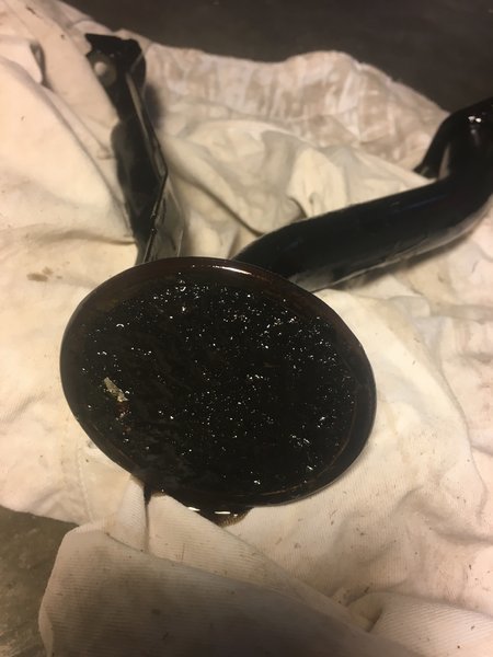

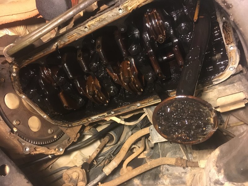

    IMG_0217.jpg IMG_0217.jpg Maybe i found the problem,pick up tube completely blocked with unknown object

  11. Dec 10, 2016 at 7:44 AM

    3,115
    Does the unknown object stick to a magnet?

    Nope thats the first thing i try after remove the tube

    Wow, that's definitely worst case scenario. Any idea what it is yet?

    Sludge,alot of them.took the tube and dip the tube and oil pan in 5 gallon full of gas and now look like brand new,just finished put the pan up just wait for the atv cured and pour new mobil1 5w30 in
