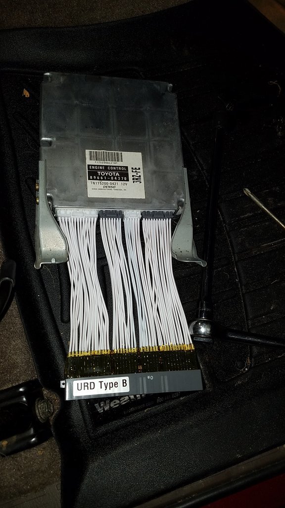

    Where do you guys locate your piggy back ecu? Got a harness from urd. Worth every penny.

    When I had a s/c, I put the ecu behind the passenger side kick panel. That was a urd ecu

    Good idea. I think I'll do that too.
