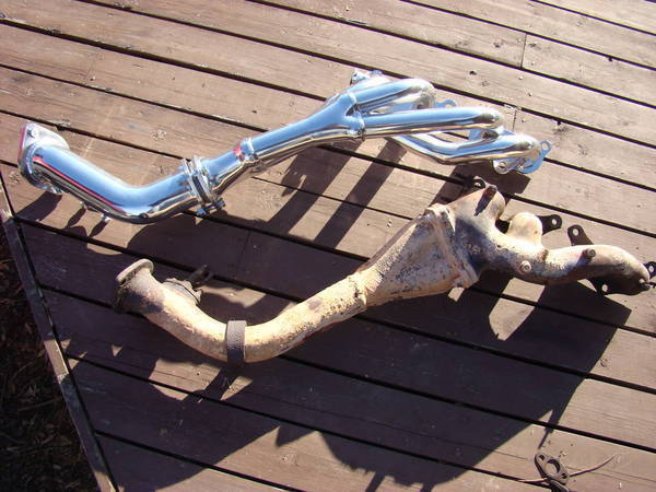

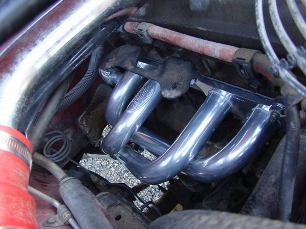

    Freshly installed Doug Thorley Ceramic Tri-Y Headers.
    Out with the old, in with the new.
    ...ooh...shiny...

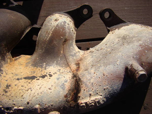

    Here's the crack...there was even more of it on the other side. I'll drop it from my rooftop onto cement to see if it'll hold up. Video to come.
    Overall, a great upgrade. Didn't really feel too much of a low-midrange power gain, but past 3500 rpms, the headers really make the engine open up.
    After the upgrade, all I can describe it as is butter. Nice and smooth.
    I spend the time or money if my manifold worked fine and didn't have a crack, but for $200 for a shipped oem manifold with gaskets, vs $350 for performance ceramic headers with gaskets shipped...there's no reason not to upgrade.
    Note: I highly recommend trading out the crappy supplied M8 bolts with stainless steel M10 bolts. 1 bolt from header-to-cat sheared on me when i gave it 40 lbs of torque. You don't want that stuff rusting together in case you want to remove it in the future without a damn angle grinder like i had to.

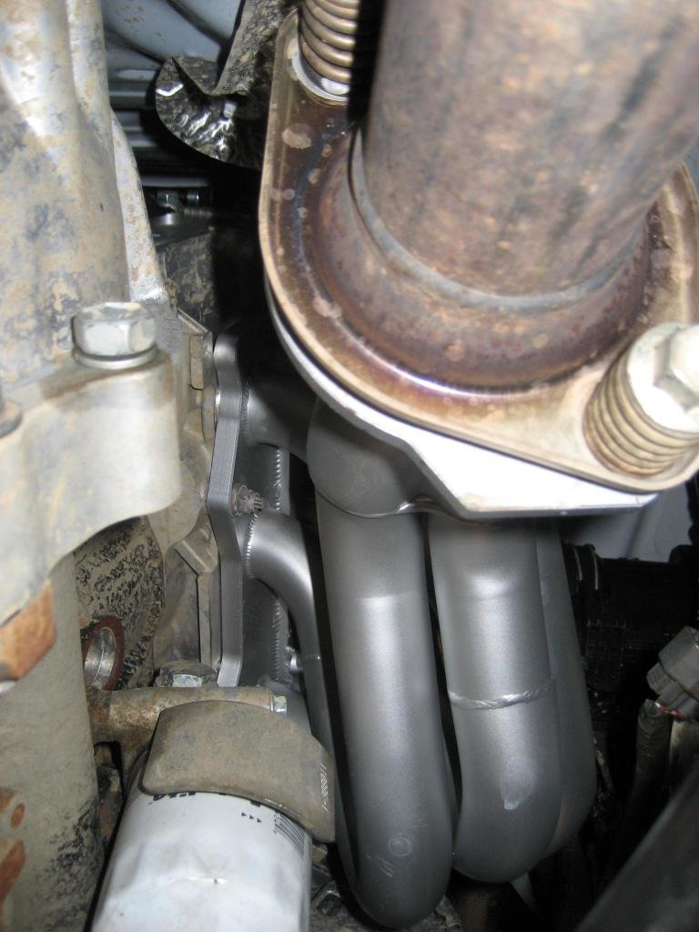

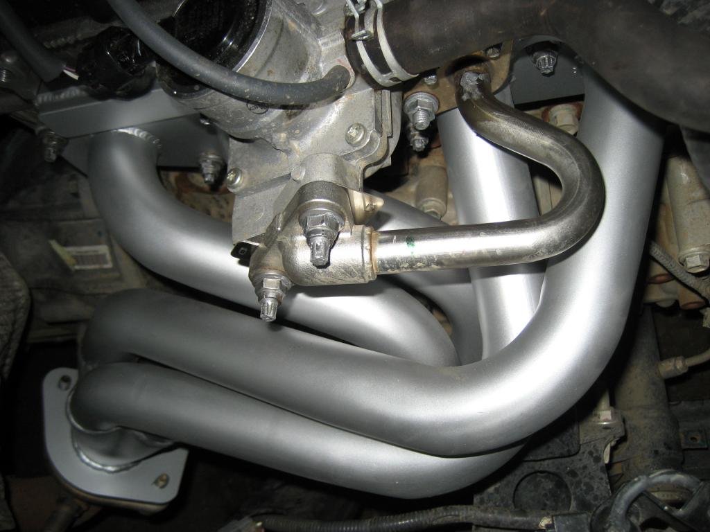

    Sure. :)
    Because the LCE long tube header is folded, it perfectly fits into space of the stock exhaust manifold. It retains all of the air injection system and will pass a smog test, but it is not smog approved in California and likely will never be. In my opinion this header is a work of art. It yields more torque than any other bolt on 2.7 mod except a $5,000 supercharger, and is far superior to the DT short tube header.

    Tooter,
    Yeah, that's a nice looking header, much different configuration than my DT... which I purchased from LCE and went with since it is CARB legal for CA.
    I didn't notice any performance improvements at all. Cool with that part but I really like the fact that the under hood temps are down.

    I understand. Raising the torque peak from 3,800 to 4,000 only adds a little more pull higher in the rpm range, but the 2.7 is a slow turning industrial type engine that has no top end to begin with. You do enjoy a distinct advantage with the DT in that you never need to take it off for a smog test. :)
