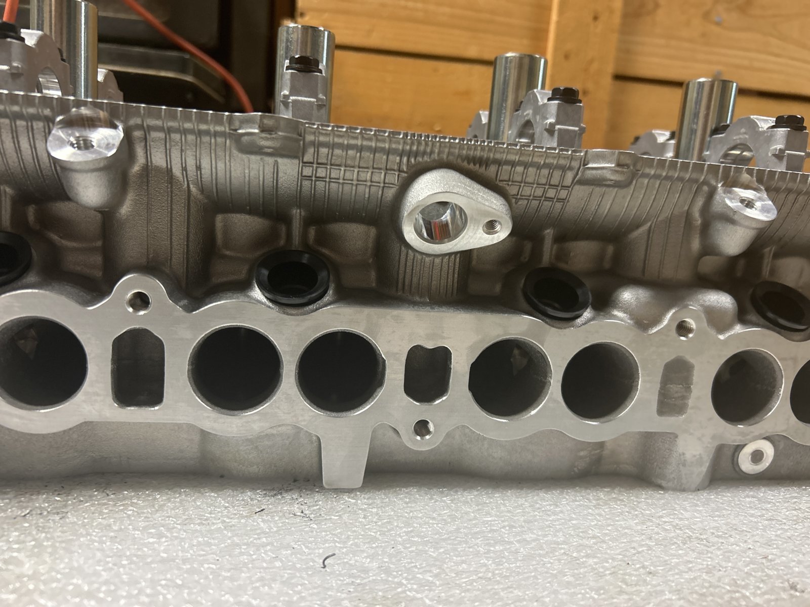

    Hey all. Recently ordered this new cylinder head and it came with a cam position sensor port above the fuel injector cups that my old head didn’t have. Has anyone had this problem and plugged the hole?

    Important part is other side ......is there a distributor hole

    Yes it has a distributor hole aswell was a bit confused when I saw this hole as it was advertised for 95.5 trucks. Think I might just make a custom plate to cover it and throw on some rtv.

    I had the other problem......mine came with a big hole.....for a nonexistent distributor....
    That was an easy one.....freeze plug fit right in.....
