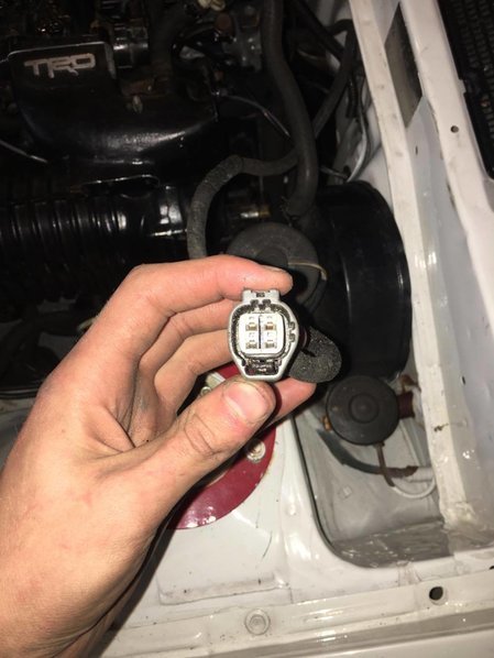

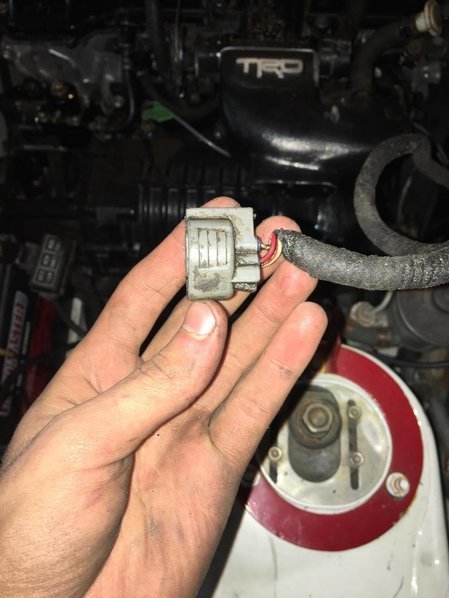

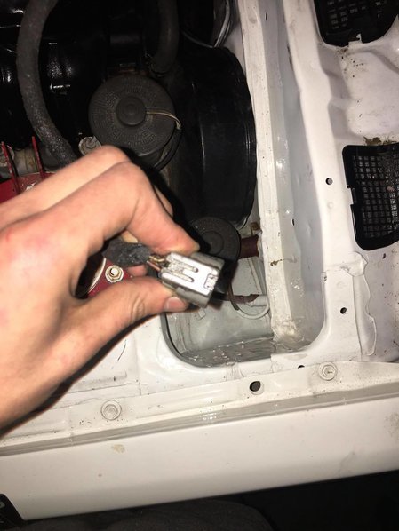

    Hello, i had a 2.7 that blew up last summer and spend the winter preparing my new engine, now that it's done I dropped it in the car and connecting everything. By the time i was done I lifted the car to do some adjusting and stuff and realized there was stiff a connector left, i spend hours trying to figure out where it went and my engine cranks but wont start, I have spark and gaz
    This is the connector, any idea where it goes? and if this may be the reason why it doesn't start?

    It's a trd supercharged 3rz

    Definitely looks like the oxygen sensor connector.
    90980–11028
    The oxygen sensor is the only sensor on a 99 that uses that connector.
