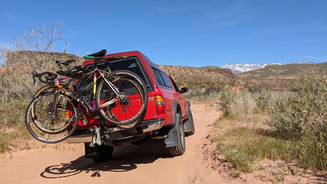

    Hello everyone :) I am a long time lurker first time poster.
    Last year I bought my dream truck - 2002 2.7L, Single Cab, Standard Trans, 4WD. The truck had about 145k miles on it when I purchased it, and I've put about 10k on it so far. Found a not quite color matched tall cap on CL shortly after which has been great for camping trips. The truck drive incredibly well in all conditions and has been a pleasure, but was definitely not treated 100% well in the past. My mechanic has recommended a number of non-urgent fixes including clutch, ball joints, rack and pinion, and shocks. So far I've done new spark plugs, drive belts, and valve cover gaskets.
    Recently, I have started noticing coolant loss. There does not appear to be any external leak, and there is no tell-tale white exhaust coming from the tailpipe. I had a few mechanics and the dealer look at the truck and everyone is telling me that I likely have a leaky head gasket or a crack in my cylinder head. The truck failed a block test but apparently the fluid was "slow" to change color, meaning the leak may not be severe. Additionally, the dealer used a camera and was able to observe some coolant in cylinder 1. The truck occasionally will missfire for about 15 seconds on cold start, which could be explained by coolant pooling in the cylinder. The truck drives totally fine and has never overheated. I am still driving it now and adding coolant as needed. I am unclear how severe this problem is and how quickly it needs to be addressed.
    Bottom line - I am trying to decide what to do and could use some advice. I have three options as I see it:
    1) Have my mechanic inspect cylinder heads. They quoted $2600 to replace the cylinder head gasket, but said it would be an additional $800 if there is a crack and I need a new cylinder head. This is a heavy investment for me but seems like the only way to be for sure that the problem will be solved.
    2) Use some sort of liquid "sealer". I've heard that a lot of people like Bar's Leaks brand and have had success with their products. I am unclear how well these work and/or if they can be trusted.
    3) Sell the truck and move on from it.
    Feeling very unsure about what the right next step is and would appreciate some advice! The truck still drives great as I mentioned and ideally I'd like to get many more miles out of it.

    If this happened to my truck I would get it fixed proper. Your truck looks well taken care of and a few thousand to fix it would be better than selling at a loss.

    fix it and keep it. You have a nice looking truck. If you repair and the problem is solved, you'll have a 1st gen that will last you for years.
