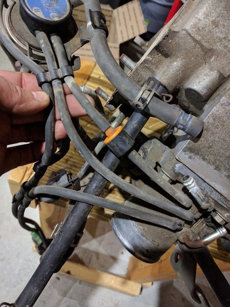

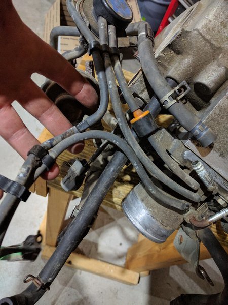

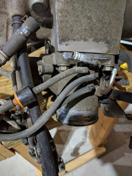

    All of the vac lines that are in your hand in the pic get deleted. All three that go to the top of the Throttle body get deleted. Anything that connects to the EGR body itself as well. Also, that little green cube under the intake manifold that the EGR vac lines lead to will also get deleted. I did this on my 3rz this summer. LMK what specific questions you have and I'll be glad to answer. I had a tough time finding some info on this. I have a shit load of the resistors too since I could only find a 100 pack of them on Amazon so if you need some of those I can send you some for free.
    I have a few pics at the start of this thread I started that may or may not be helpful to you. I might have a couple more on my computer at home, i'll check it out later.
