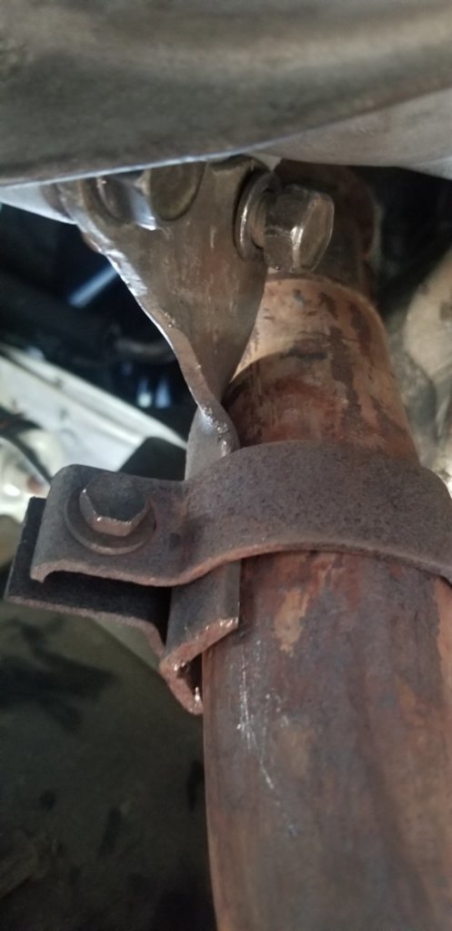

    The Exhaust Pipe Support Bracket 17571-0C050
    I believe this is the part that connects to the bellhousing, not sure if it comes with the ring clamp, need to investigate more, also need to find bolt part number aswell. Going to dealership to see if they have a bigger picture exploded view by providing them this pn.

    So you can get the metal piece that wraps the y pipe from a 2rz engine but the bracket that attaches to the trans bellhousing you have to get from a 3rz or buy new from dealer, the clamp has no pn, get from junkyard
