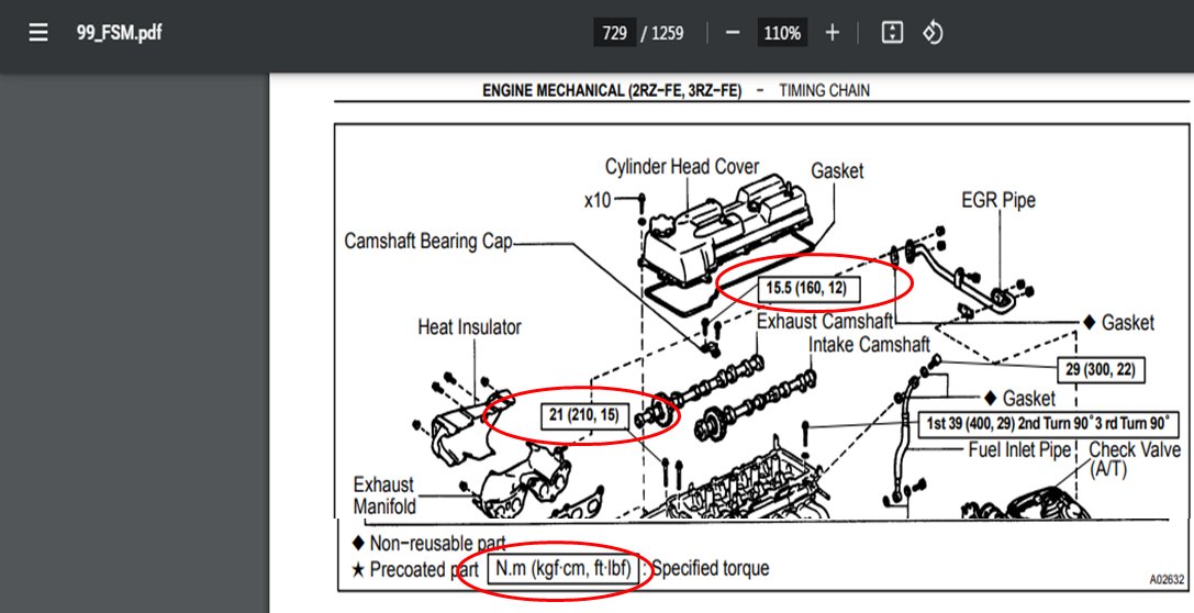

    Hey what should I torque the exhaust cam to? "I have to take it out because the rear valve is like impossible to get to."

  20. May 14, 2021 at 7:44 PM
    #20
    Wsidr1
    Wsidr1 Well-Known Member
    Jul 11, 2018
    #259004
    3,079
    Indiana
    2 x 95.5 Ext 2.7L & 3.4L A/T 4x4
    A little bigger copy:
