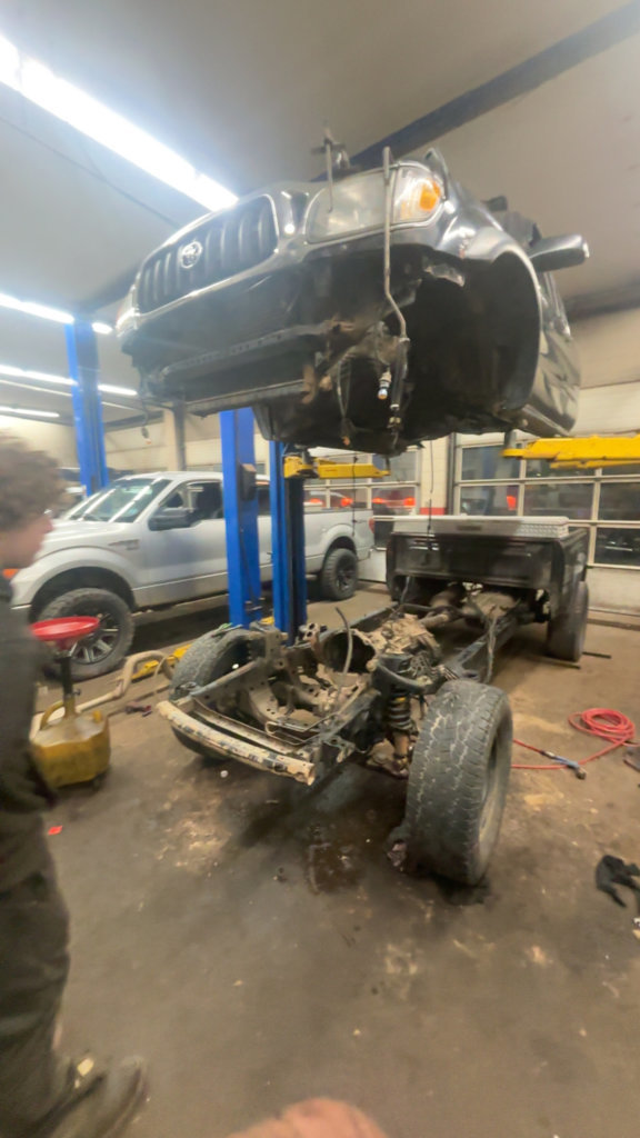

    IMG_6137.jpg IMG_6166.jpg Hey all, I recently replaced my old and tired 3rz-fe for a lower mileage one. but I’m having trouble since with a high idle (2000 rpms) an idle surge (1500-2000) and a really hard cold start have to hold foot to the floor sounds like a lawn tractor when it does start and keep it floored till it works through the misfires and stuff and comes to a smooth idle at 1500 rpm and slowly rises stopping at 2000 rpm. Once up to temp starts fine but same problem after about 4-5 hours of sitting I had a code for engine coolant temp sensor and I remember reading forums about it before causing similar issues well wouldn’t you know I never plugged it in lol plugged in cleared codes (left battery unhooked for 5 mins with headlights on) code didn’t persist but the issue did
    I’ve been told by a friend the vacuum for the front differential could’ve gotten unhooked when the old motor was removed and new one was installed but as far as I can tell every vacuum line is on and connected. The new motor also was known running with no CELS in the parts truck I pulled it out of.
    so my question stands how can this engine run perfect last weekend and like this the following weekend? With no CEL’s Makes no sense to me.
