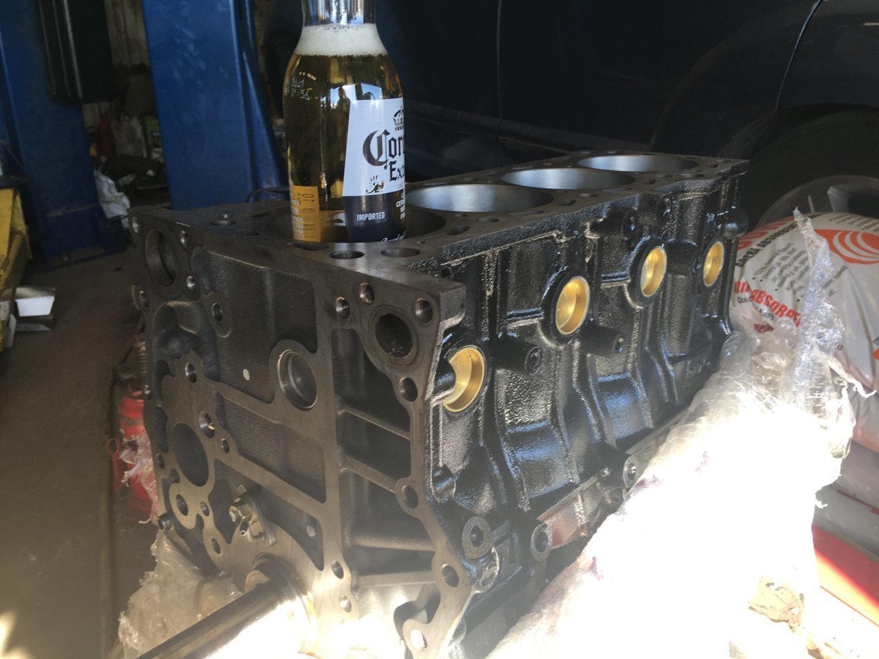

    Ha! - It's just a shame these engines are only 4 bangers, less room to hold beer
