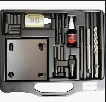

    There’s a company that makes a kit to repair the aluminum threads with a Timesert. I got it used on eBay with half the inserts used. I got replacement pieces and sold it again on eBay after I was done. The thread repair ended up only costing $100 between shipping and parts.
    #47
    Langing[QUOTED] likes this.

    When I did my Camry head, I knew the engine was a little tired when I did it, but it was so much cheaper, and it ran really well even when it was bad. I rolled the dice and it worked out great.
    Here’s the kit I used to fix the block.

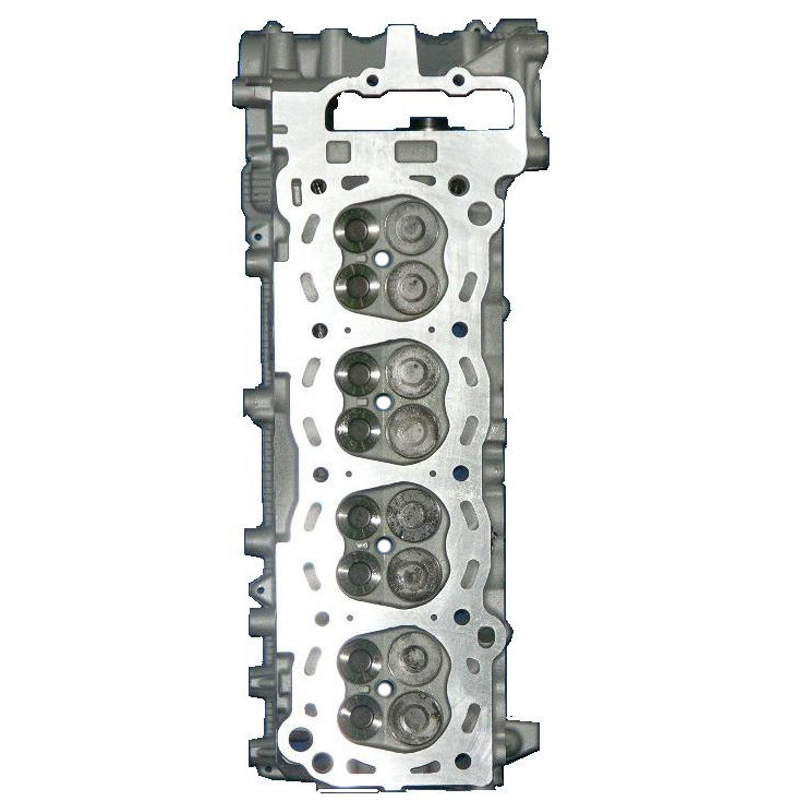

    Sounds like the plan! Thanks, I've priced out quite a bit, with a new assembled head I'm at about $2,000, gasket set, fuel filter, oil pump, water pump, seal packing, exhaust/intake studs, fuel cups, spark plugs and a few tools I don't have.
    wish this could figure out who rebuilt this.
    https://www.ebay.com/itm/195576571562
