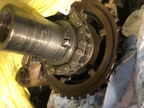

    great! Thanks!
    that camshaft bolt was on there good!!!!! That took ever ounce of muscle I had yanking on her!

    Yeah they actually recommend you replace that...
    I did on mine....but I'll reuse it from now on.....cause I know its history....
    If that bolt backs off its your worst nitemare.....means a new crank shaft.....
    Only time I've seen em back off .....is when the Harmonic Balancer is going out.....all that starts to wobble.....especially under load or AC running....

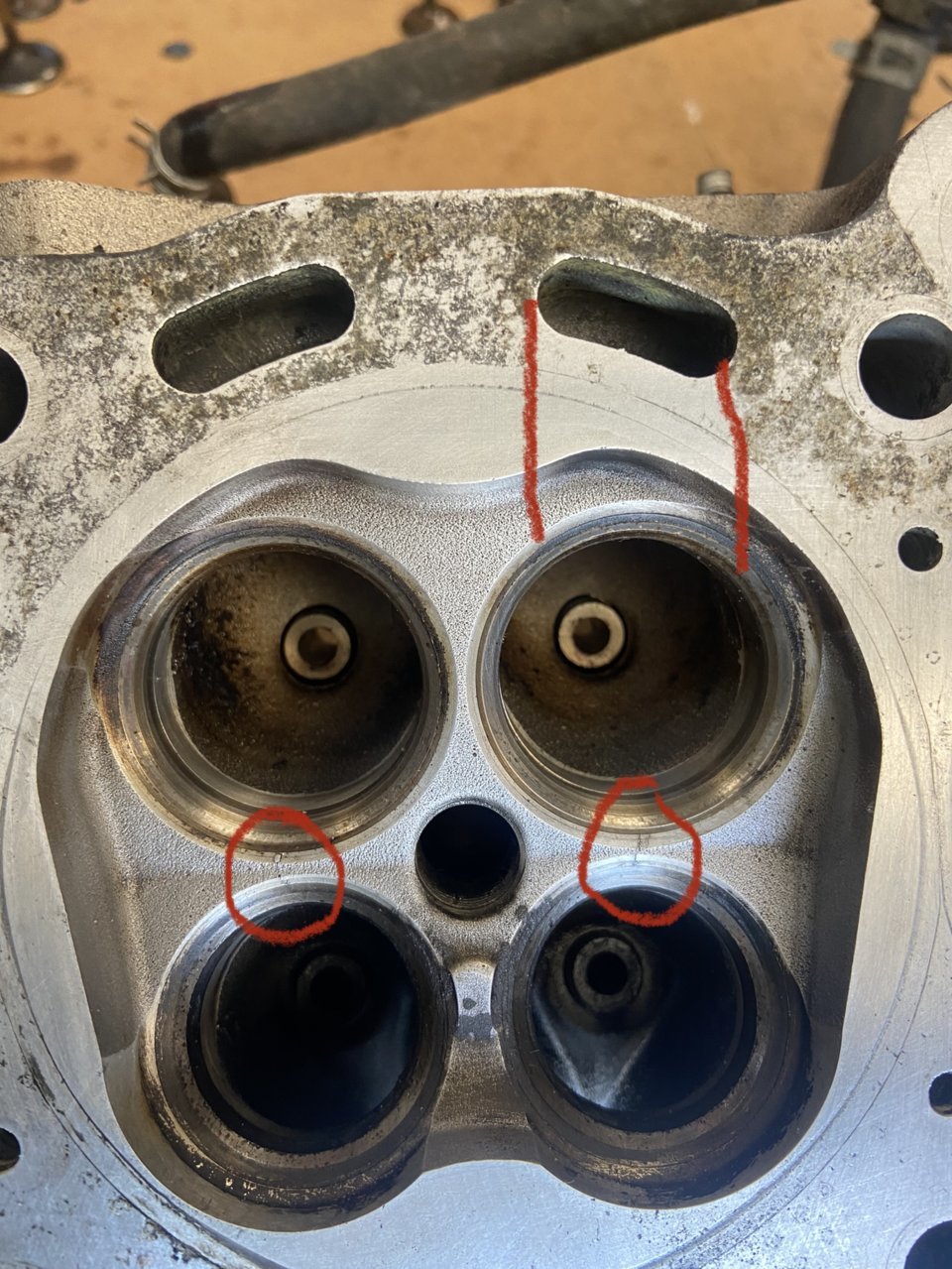

    Haven't had time to work on it, just got off my 48 hour shift. But it does looked cracked, it extends down where the valve was. I'm curious if that red path I drew was the path of the coolant, how it's all clean?

    He says in that video.....the surface cracks only get worse over time....
    I'm starting to suspect they use lower quality 6000 series aluminum in these heads...
    that aluminum is alot cheaper and much easier/softer to machine than 7000.....
  15. Sep 6, 2023 at 3:04 PM

    got a new head coming! Probably 3-4 weeks out

    Again as I've said.....think its an old dirty egr that causing the overheating in the first place...
    that and possibly old coolant.... corroded radiator......iron exhaust header...
    maybe that aluminum is like old copper...gets pretty brittle 20/30 years later.
    reflairing lines that old is spooky.....

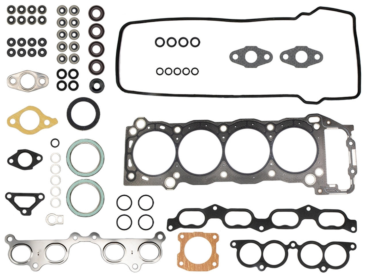

  19. Sep 13, 2023 at 10:32 AM
    #79
    woad4
    woad4 [OP] Well-Known Member
    Feb 10, 2022
    #389849
    208
    2003 Tacoma Xtra Cab
    3rzfe

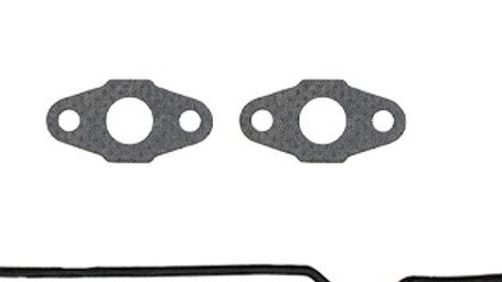

    Just got the full toyota gasket kit, I know what all the parts are for except these 3?
    I have one of each rubber piece and 16 of the middle pieces.
    Any ideas?
  20. Sep 13, 2023 at 11:14 AM
    #80
    Old metals
    Old metals Well-Known Member
    Nov 14, 2022
    #410626
    151
    John
    02 x-cab 4x4 2.7 2018 TRD Sport 4x4 3.5
    Original
    Can't help you but I do know that I wasn't happy when I spent that much on the same kit you have and it came with no index.
