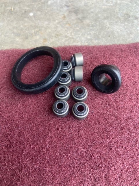

    The 16 pieces are valve stem seals, no idea what the others are yet.

    3rz to 2Rz bebuilt block and new heads

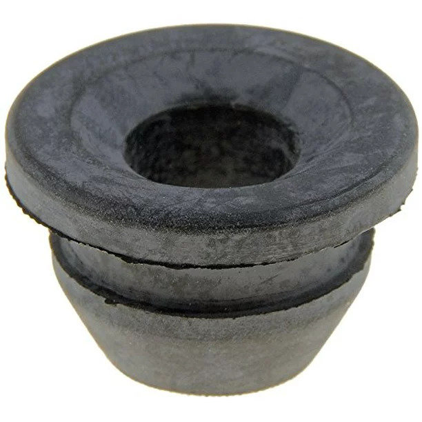

    The big fat plug one is the pcv grommet for pre 2001....

    AYO! I guess that's why I haven't recognized it yet, mines an 03.. now just gotta figure out what that round rubbey is!

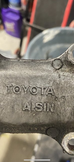

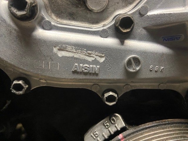

    Just waiting for the head, had some spare time to install the new water pump. The new water pump was purchased from Amazon instead of Toyota OEM ( for obvious reasons((same company, 50% off)). Looks like someone in the Aisin factory job is to grind off the words Toyota on all water pumps haha.

    The large seal (on the left) is the gasket for the oil fill cap on the valve cover. you are welcome

    Thanks!!!

    The 8 parts in the middle are valve stem oil seals, either intake or exhaust. I cannot tell you which. Let's say they are for the intake valves. When you take off the valve retainer, keepers, springs, you will come to the valve stem oil seal. I replaced all of mine when I cleaned out all the oil sludge from the upper part of the engine. That's the only reason I know.
    I will guess that the rubber grommet on the right is for your PCV valve in the valve cover. That's what it looks like to me. Some PCV valves are threaded, but some are without threads, and have a grommet inserted before you insert your new PCV.

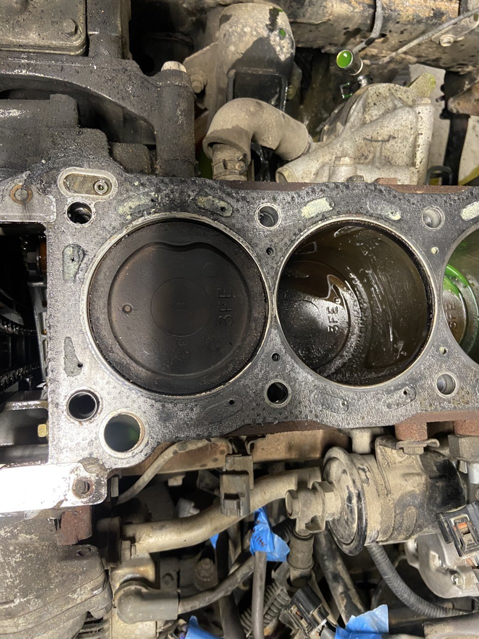

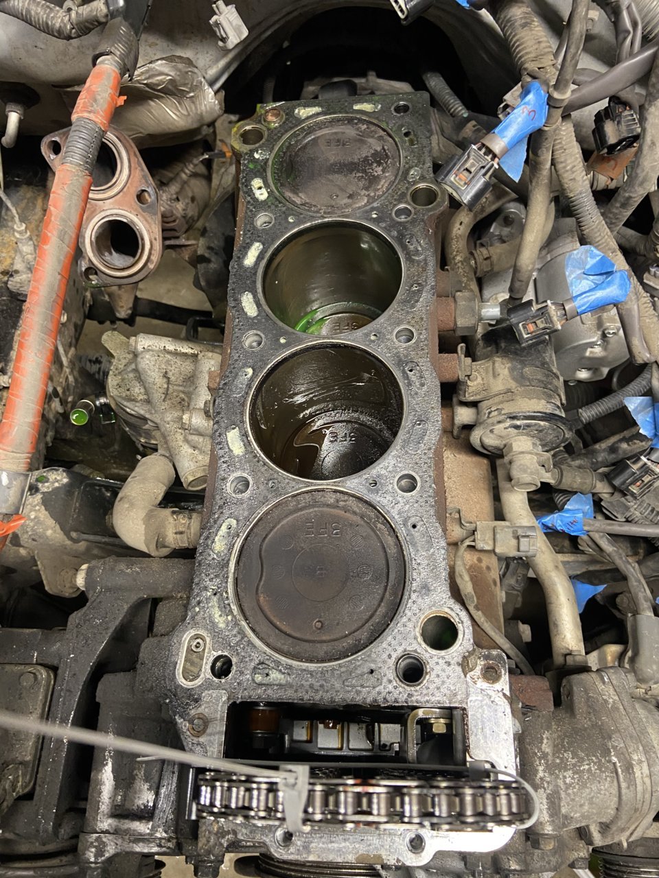

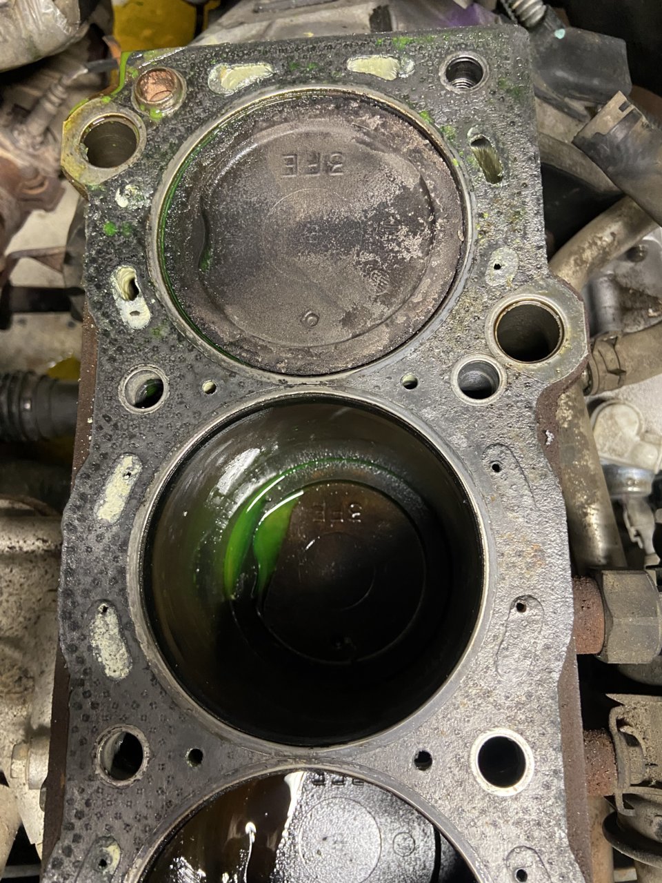

    The bright green color jumps out at me. You have coolant going into one cylinder, indicating a problem with your head gasket.
  9. Sep 15, 2023 at 4:38 PM
    #89
    woad4
    woad4 [OP] Well-Known Member
    Feb 10, 2022
    #389849
    208
    2003 Tacoma Xtra Cab
    3rzfe
    I discovered a crack on my head on that cylinder. Side note, that's the pink Toyota antifreeze, with uv dye added to it a week before this trying to find the leak, causing it to be florescent green.

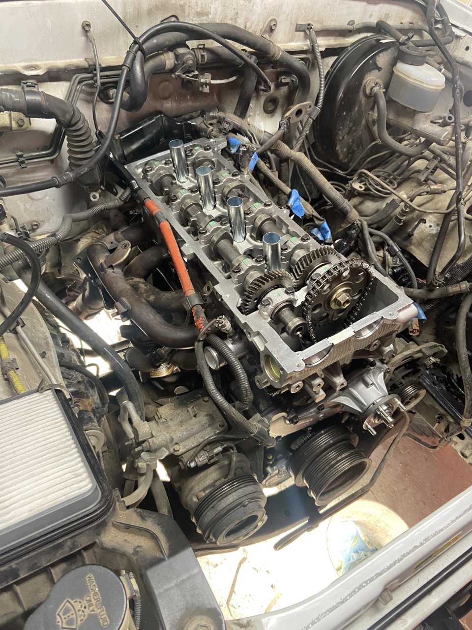

    Was able to get in the garage for a few hours today. I enjoyed setting the exhaust sub gear on the cam.. Getting those spark plug tubes set into the head was not fun at all.

    I finally fired up the truck after that work.... I now have P0300, p0301, p0302, p0303 and p0304 on my truck. It cannot hold idle without a slight RPM increase, even then, it's not very happy so I stopped trying.
    I feel like the obvious answer is either a vacuum leak or a timing issue? All the hoses I can visually see are connected.
    The timing seemed almost impossible to mess up? Exhaust cam gear and sub gear were lined up from the shop, with a service bolt placed through them, bolt was removed just prior to valve cover installation. The 3 dots in the back of the cam's were lined up with TDC, chain tensioner seemed to install just fine, made 3-4 rotations with a 19mm and heard no bad sounds.

    Recheck all your wiring....recheck each engine sensor connector....
    recinch all your ground points......deoxit would be best...
    these are really very simple engines.....
    See this all the time....and its usually something to do with an engine sensor.....
    before I'd fired anything up.....I'd put a resistor between the pulled battery cables...
    for couple or ten minutes to drain and reset everything........
    I'd see it as a nothin to loose step.....

    Also check your evap system carefully.....if you choke off the canister flow into my throttle body.....I get exactly that stumbling you describe.....
    not sure if its low fuel or a vacuum issue causes that....
    even the egr valve could be sticking or malfunctioning.....
    Best thing I can tell you is 'Live data' off a scanner is your best friend.....
    even my blue driver will do upto six variables at a time....
  15. Sep 19, 2023 at 6:47 PM

    The only diagnosing I've been able to do tonight is check compression again, I have 185 psi in all 4

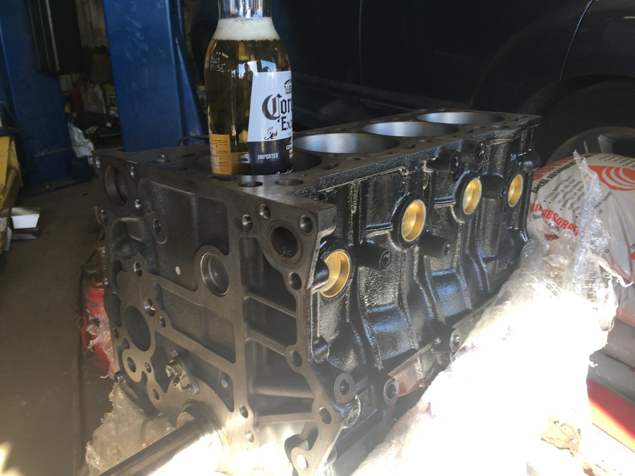

    You mean this one.....
    dang mexican mechanics....I couldnt even hardly see straight that day.....

    Yeah the progress on my engine was much slower than yours....
    about 6 12packs slower than yours......no kidding......
