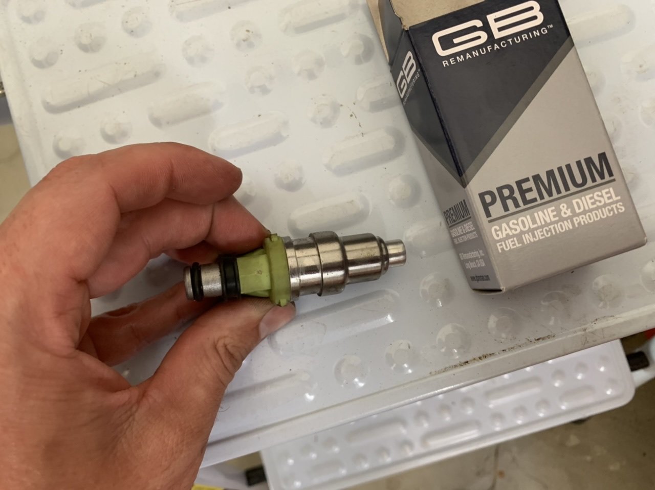

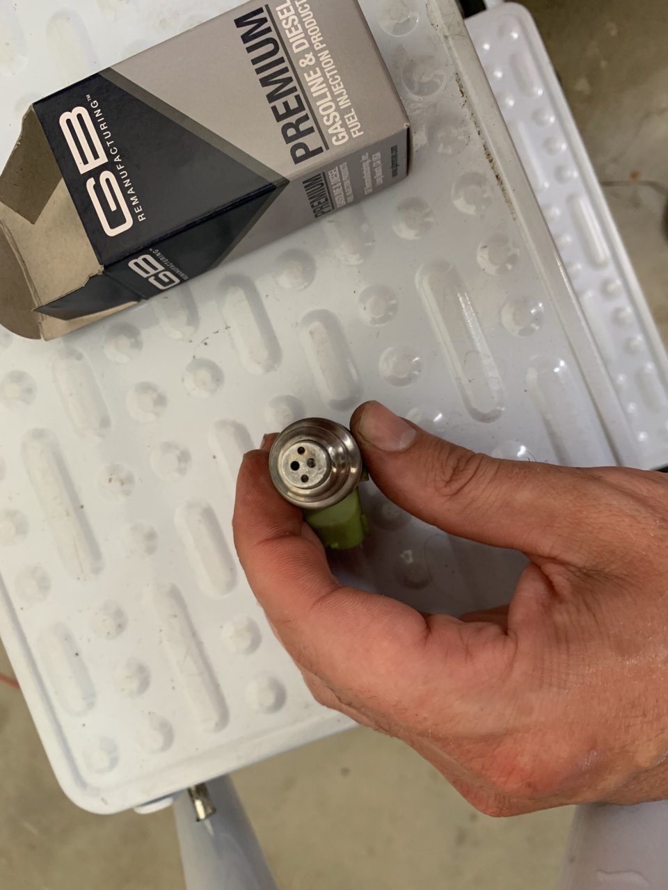

  17. May 31, 2020 at 12:02 PM
    #17
    Steeprock
    Steeprock [OP] Well-Known Member
    Jan 1, 2020
    #314825
    93
    1997 Regular Cab 4wd Tacoma
    Well I think I found the bad injector, one of the four sent by rock auto had a different color than stock and the other three they sent me.
    I hoped to be able to see the fuel on the valve or in the cylinder; I could see neither. I couldn’t hear any difference in the injectors either with a stethoscope. Only difference was the design of the ports where the fuel comes out so I chose to replace that one and so far so good.
    by the way my fuel pressure is holding at 45# now with the car off.
    pics below of the black sheep injector.

  19. May 31, 2020 at 7:48 PM
    #19
    Steeprock
    Jan 1, 2020
    #314825
    93
    Well it’s official it was the bogus injector that they sent me that was causing the rough starts.
