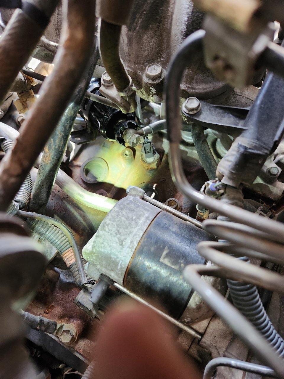

    Hey yall. Got lazy and didn't feel like crawling around on the gravel awhile back so I took my 3rz powered truck to a local shop to slap in a fuel filter. Immediately after leaving the parking lot my cel came on and the truck drove a little shifty. Anyway I figured it'd be from the new fuel filter or something so I stopped and scanned the codes. P0325. I was digging around and noticed the fuel filter was slammed into the knock sensor so I started tearing into it.20230205_122628.jpg

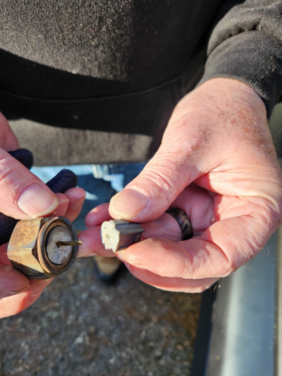

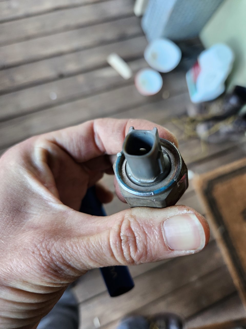

    These idiots only had one of the mounting bolts in the fuel filter and had snapped my knock sensor 20230205_130544.jpg 20230205_154706.jpg

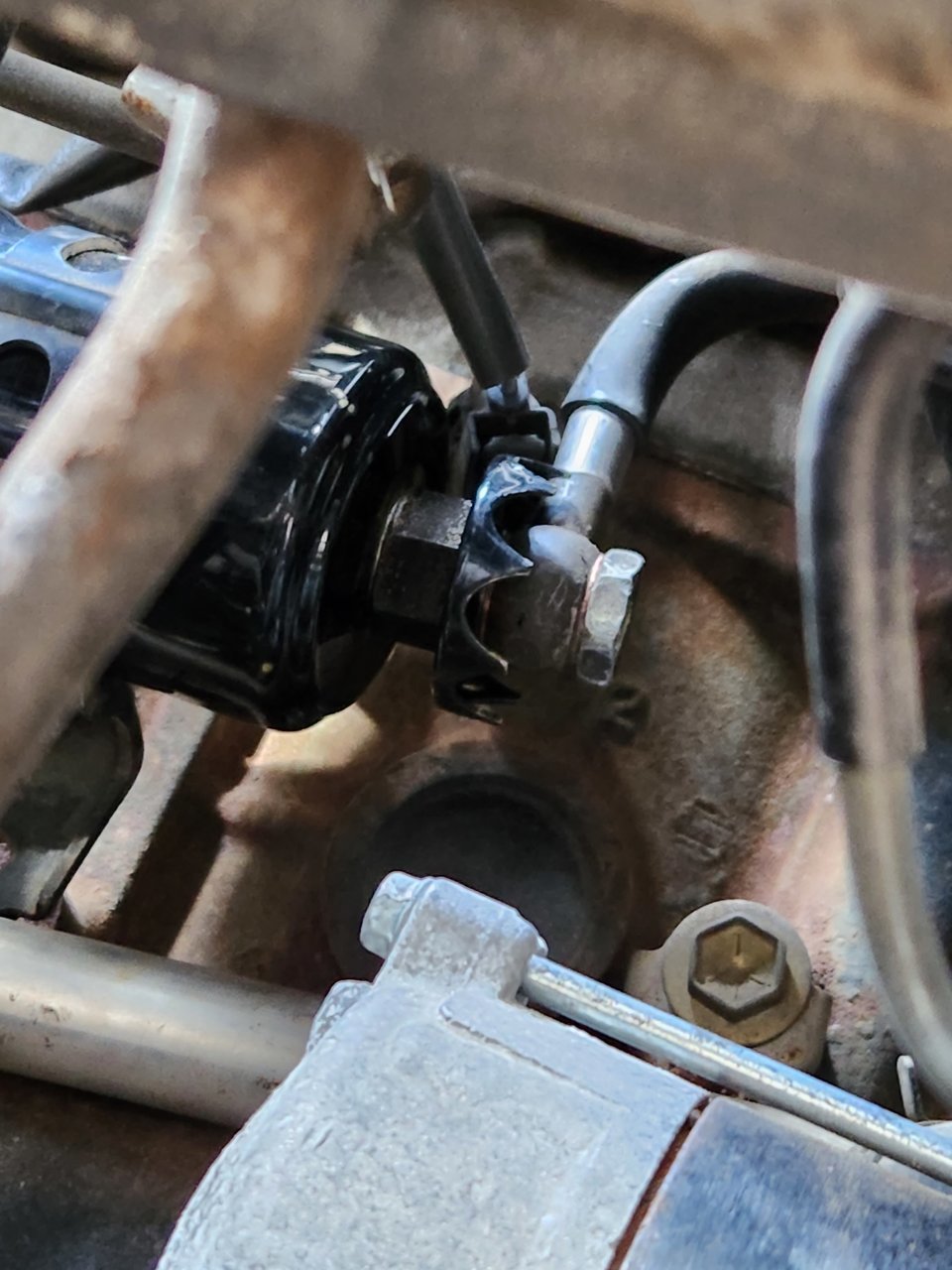

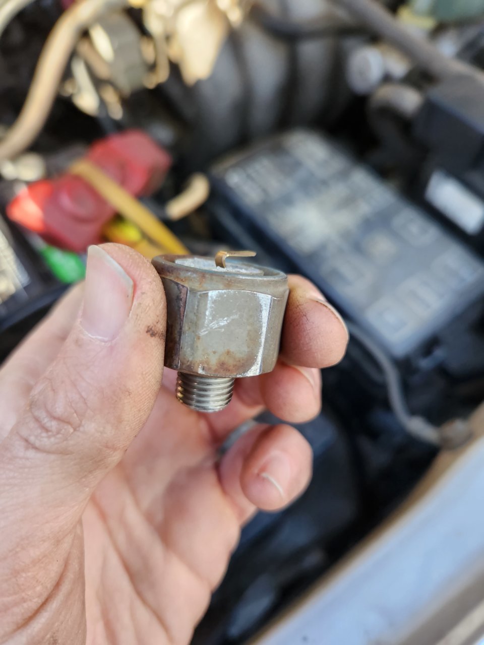

    Anyway I straightened the pin out and epoxy it together. Letting it cure now hope this works20230205_155101.jpg 20230205_171128.jpg

    Just ran the truck. No cel. Revved her pretty harr too
