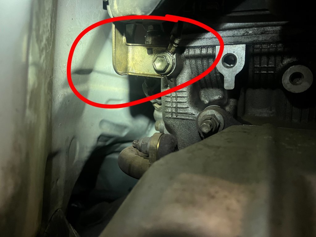

    Excuse my ignorance - I know my engine bay well but for the life of me I can’t figure out what this is or WHY there’s oil seeping..
    Found some spatter on side of my bell housing where the exhaust downpipe bolts into it and traced it up to this area right above the exhaust manifold at the back of the block where a bracket is holding up a grounded line - circled in red in last pic
    Thoughts?

    Valve cover gasket, very common place to leak on lots of different vehicles, not just toyota
    Make sure to get a gasket kit with tube seals included. Also a good time to do spark plugs while you're in there

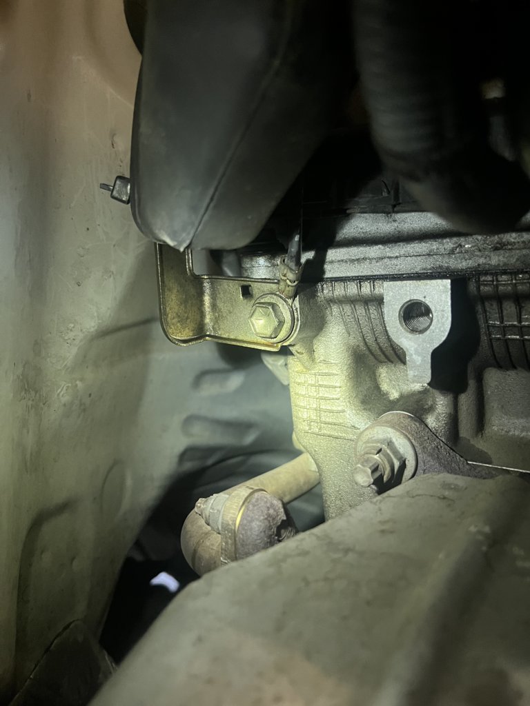

    As stated, look up high first at valve cover area...
    If leaking high & running down, oil pan area / trans area will look wet & if you have tunnel vision, you will chase the wrong repair.
    Dont play games & source a toyota VG gasket if in fact thats what it is....
    Cheap enough & will be better than other options, ive used them all........

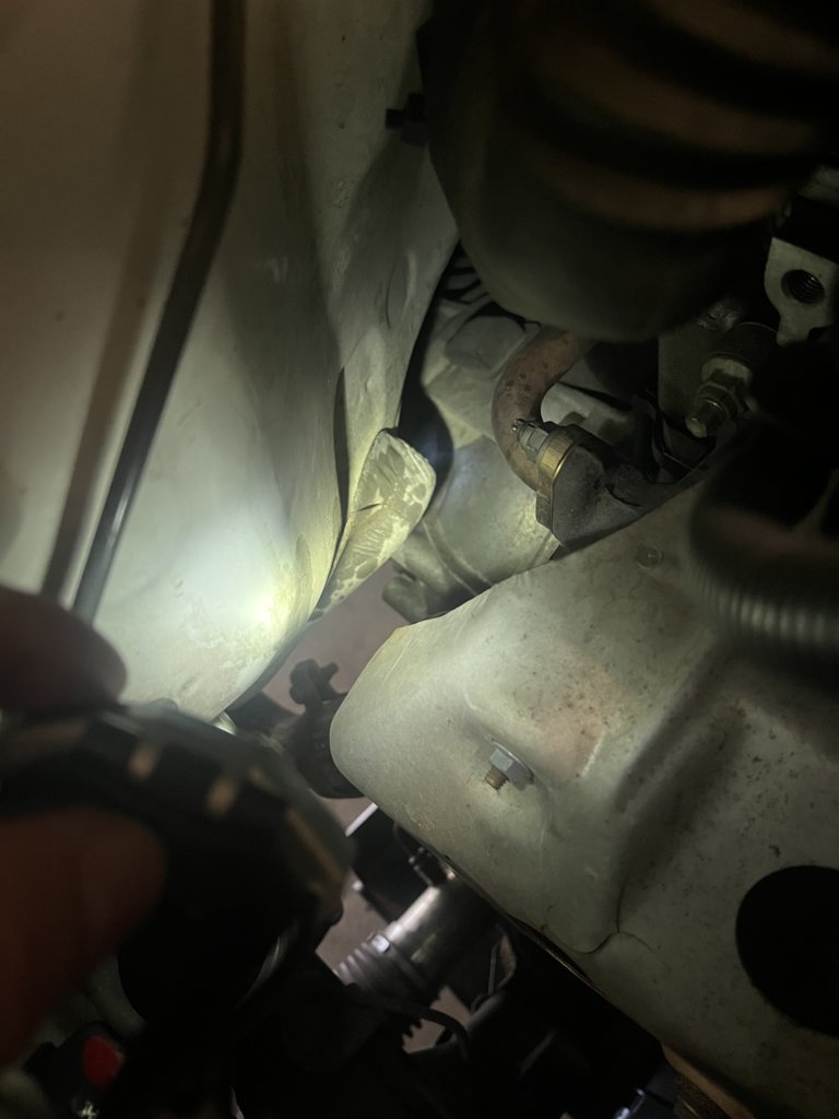

    yup its leaking down on the bell housing (at the exhaust downpipe bolt).

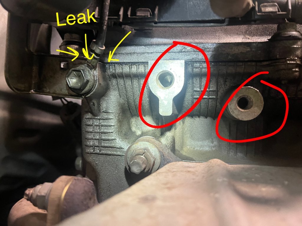

    Better view with I take tube off

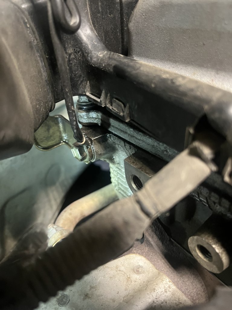

    Pic off where valve cover gasket is leaking but also curious what these two
    Threaded holes are for right next to circled
  9. Mar 11, 2025 at 2:42 PM
    se7enine
    se7enine MCMLXXIX
    Apr 18, 2013
    #102322
    23,442
    Reno, NV
    Left hole is for engine hook for hoisting. Other is unused.

    Lineman
    On my 96 2rz
    Those empty head female holes are for a bracket that holds steel air intake resonator
    Bet redesigned for your taco
    Good 4U
    They are kinda a pita to thread

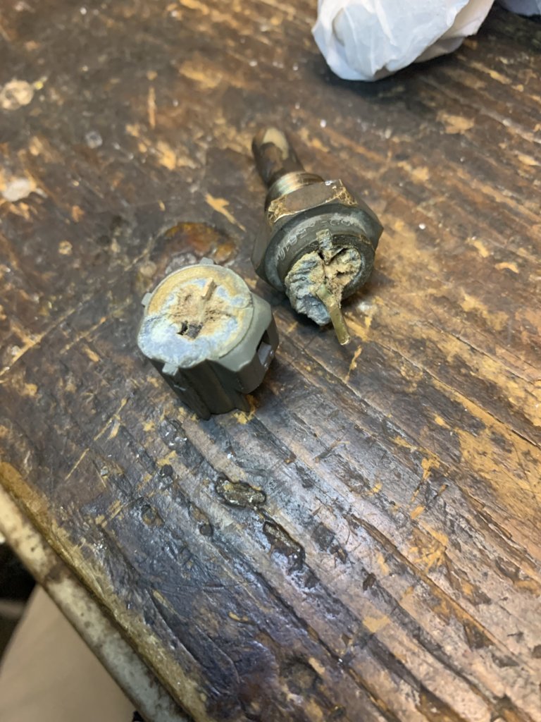

    Might be worth RR’ng the CTS on back of head. Super easy if valve cover off. Again, can be done with a contortion body.
    I had no start condition, Glasiman helped me discover that my 3month old new CTS failed
    my 1st one:
    they are not too expensive
    Definitely less than complete VC kit
    17mm or 19mm deep socket needed

    CTS as in Coolant temp sensor?

    Yep coolant temp sensor
