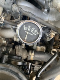

    2.4L 1996
    Gauge tested….accurate.(60yrs old)
    I’m wondering the same
    Every other car I have wrenched on, FP usually 35-42lbs
    Read/searched and 20-22lbs is typical
    I’m still not positive about this
    this gauge is before FP regulator, only way to mount as FPR bolts on to fuel rail.
    Have my suspicions as I’m suffering from ‘hot no start condition’

    Turns out new FPR arrived today
    (I tested old one…passed)
    Test was running for 15m and seeing if fuel would flow through diaphragm thru vacuum outlet
    when I installed new $16 FPR
    There was FP….dripping/spraying down side of block

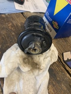

    Just RR’d FF too
    was nasty

    Levis…….
    Same 20lbs
    Hot/cold
    Revving/idle
  17. Aug 19, 2023 at 5:55 PM

    And yeah ....if you dont know the age of your fuel filter....its time to replace it....
    that can leave you stranded....
    Be super careful with those hoses on each side of the filter......they run about $200 ea.....
