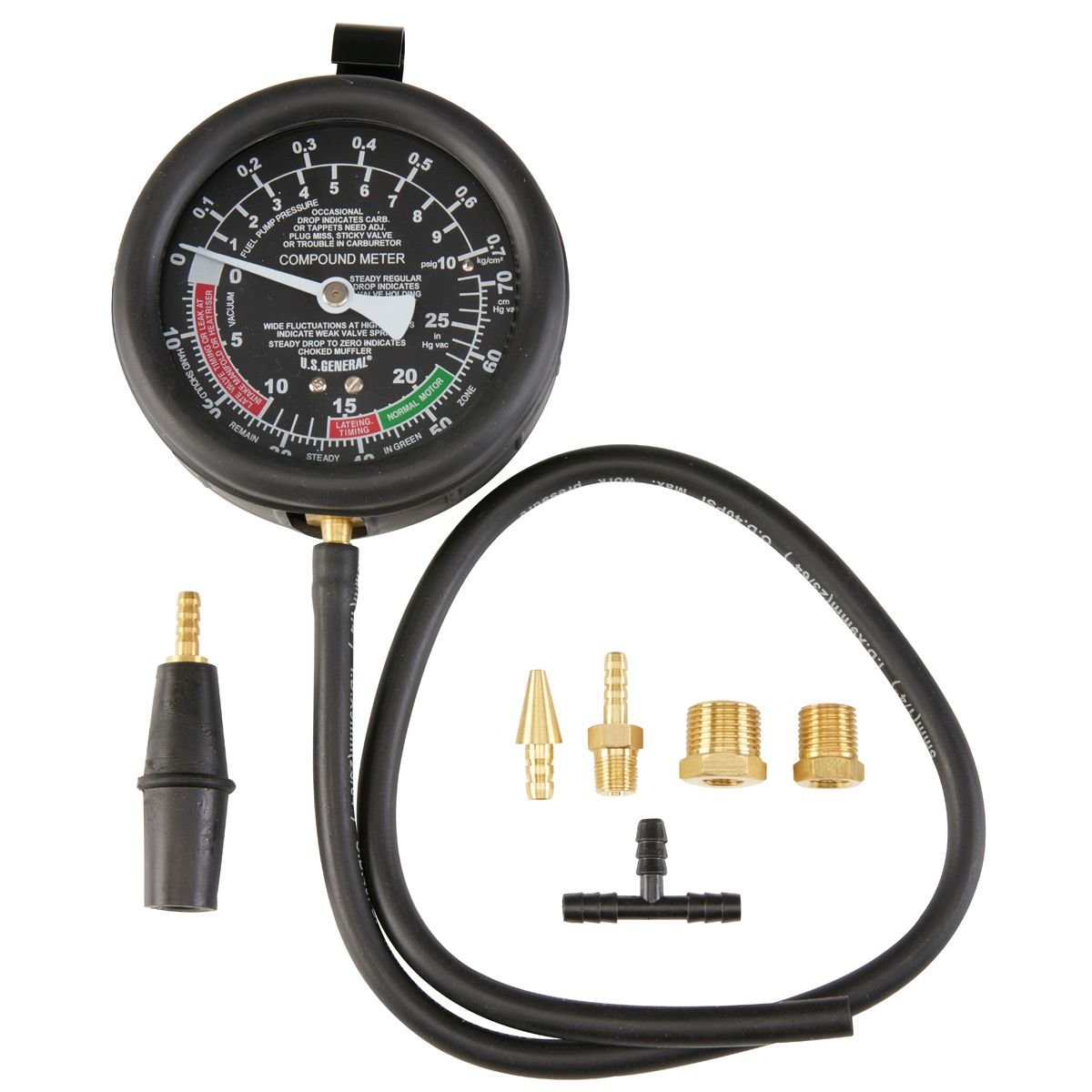

    I think HF has these for about $15......

    I actually bought one of those but I used a different larger dial one from the parts store. At idle I've got like 20 and when I rev the engine it increases vacuum what I guess would be good. I need to rig up something to get fuel pressure reading. What brake boosters are yall using to replace the oem one? Surely some aftermarket company can build a halfway decent booster.

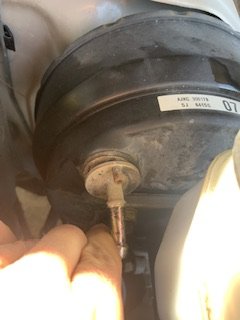

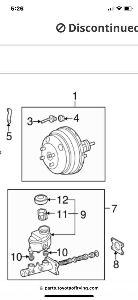

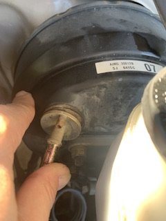

    IMG_3341.png OMG beezer thanks so much ^^^
    Site saved.
    so again, just discovered the booster check valve IS NOT inside the BB vacuum hose like many cars I have wrenched on
    It’s separate
    But I noticed that the rubber check valve grommet is beyond loose/perished
    #4 in above
    will see if still available

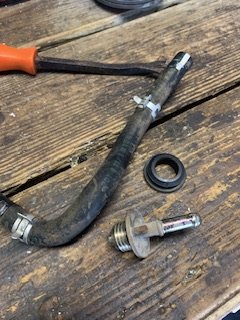

    Check valve is good
    Going to clean/lube grommet

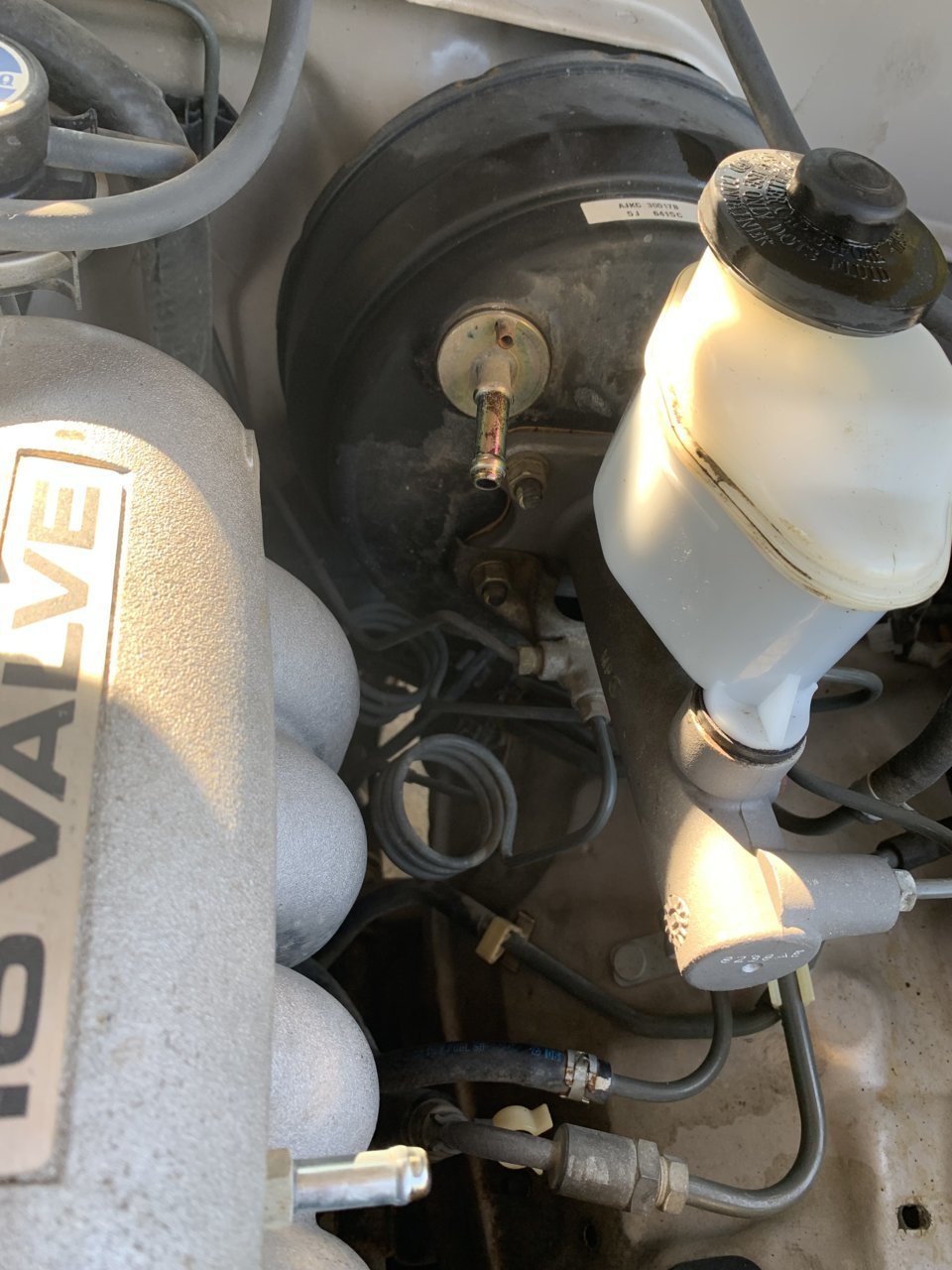

    Both BB tests under that BR section passed
    did find out from same link that my FP gauge is mounted on return line!
    Ugh
    No wonder it’s reading 20lbs

    Fellas. That's where my booster is leaking. I sprayed maf cleaner there and it brought the rpms up.... not much but with a scanner on it was obvious. I'm gonna try the grommet for now before I replace the booster entirely. I did replace the maf with a Hitachi unit and it improved drivability at rpms over 2k, when the vacuum leak is overcome. At these rpms while cruising my fuel trims drop the zero.
