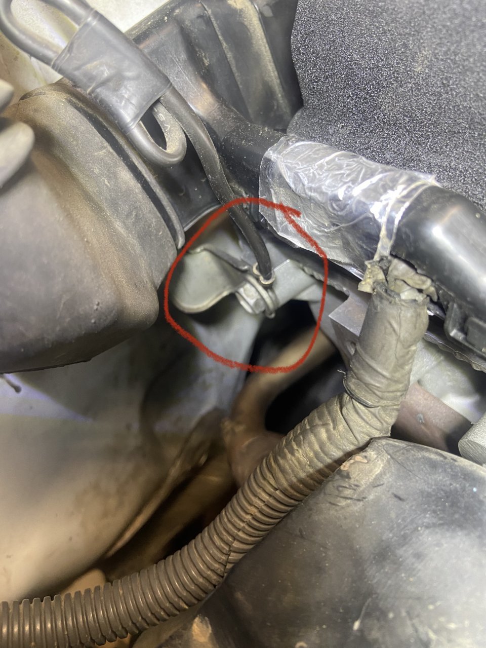

    these are the three grounds I remember taking off.
    E4FC3DD0-6046-4F87-864B-0FDF86231FCB.jpg E351BB29-1C74-4365-A95D-ACD05FB5954D.jpg 7AB57F65-F66D-4A92-BF69-683D21CA5CE3.jpg
    Bishop84[QUOTED] likes this.

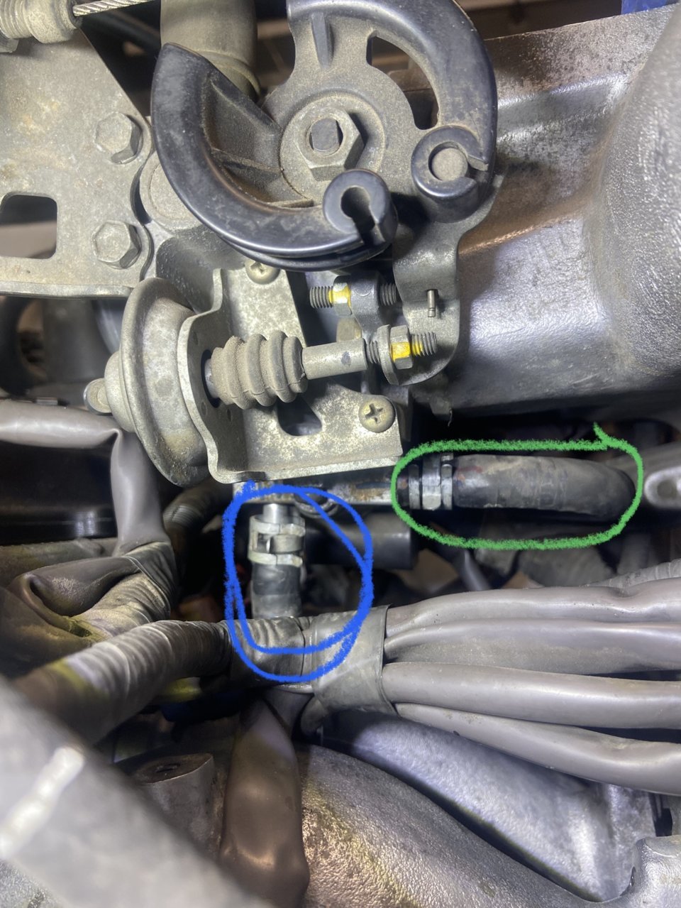

    BD2131E1-CA06-4DCD-86A6-CA5684D0EC24.jpg 700E1A44-F23F-433F-B2FE-6ADA73D46892.jpg
    looks all connected these two lines are suppose to have coolant ya? Looks like a flow path if I followed them correctly
  19. Sep 19, 2023 at 8:29 PM
    #19
    O'Silver_Taco
    O'Silver_Taco Well-Known Member
    Aug 26, 2021
    #375390
    4,207
    MD
    98 Dlx Sr5 ext AT Rwd
    3rz to 2Rz bebuilt block and new heads
    Top pic is h2o out of egr valve....
    that should go into iac.....
    lower pic is iac h2o out.....
    terminates into back of engine.....

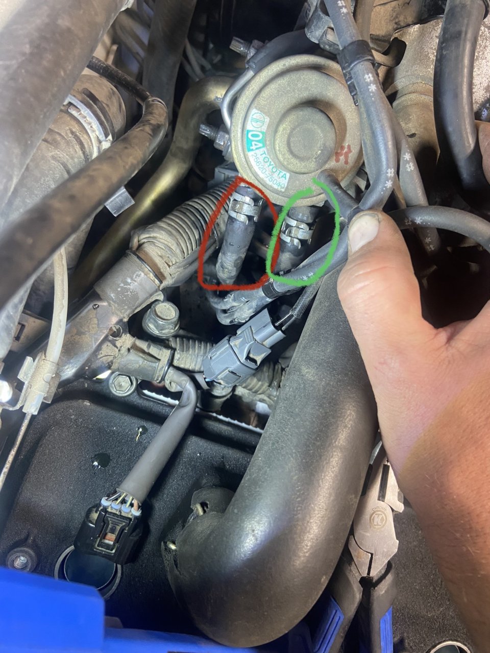

    I'm 90% sure I have the correct routing for the EGR and IAC.
    Green on the EGR goes to Green on the IAC.
    Red on the EGR goes to a split along the firewall, one split goes to firewall, other split goes to thermostat.
    Blue on the IAC goes to the a port on the back of the block.
