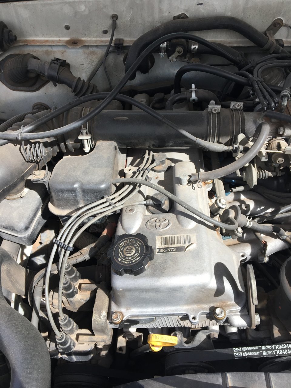

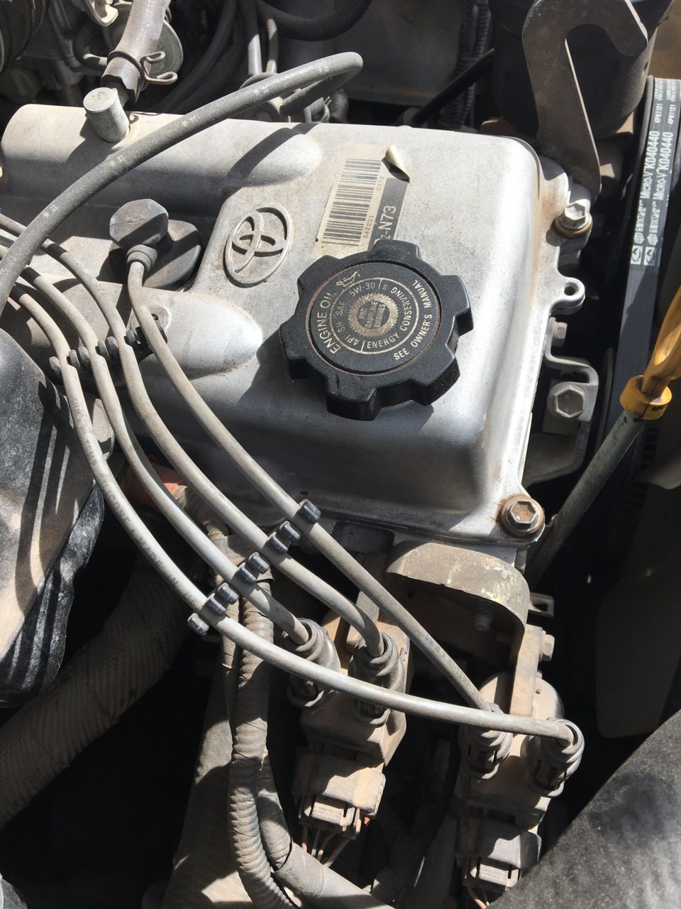

    My 1998 tacoma has a rare engine, so i've read and researched. The 3RZ-N73. I am looking to swap the engine for a new one because this one isn't doing so great. It has 220,000 on it so i decided its time. My only concern is the coil packs. The packs on my engine are on the left side down where before was a distributor on earlier models. I have never seen any other engine like this. Everything i have found with the coil types are individual packs on top of each cylinder. Does anyone have any information or experience with the N73?

    Every single 3rz from 97-98 to 00 had twin coil packs.... On the RIGHT, or passsanger side if the head.
    The 3rz that was in my truck was just like yours. Nothing special, or rare.

    My 3RZ looks just like yours. Doesn't have the tag on the valve cover anymore. Fell off awhile back
