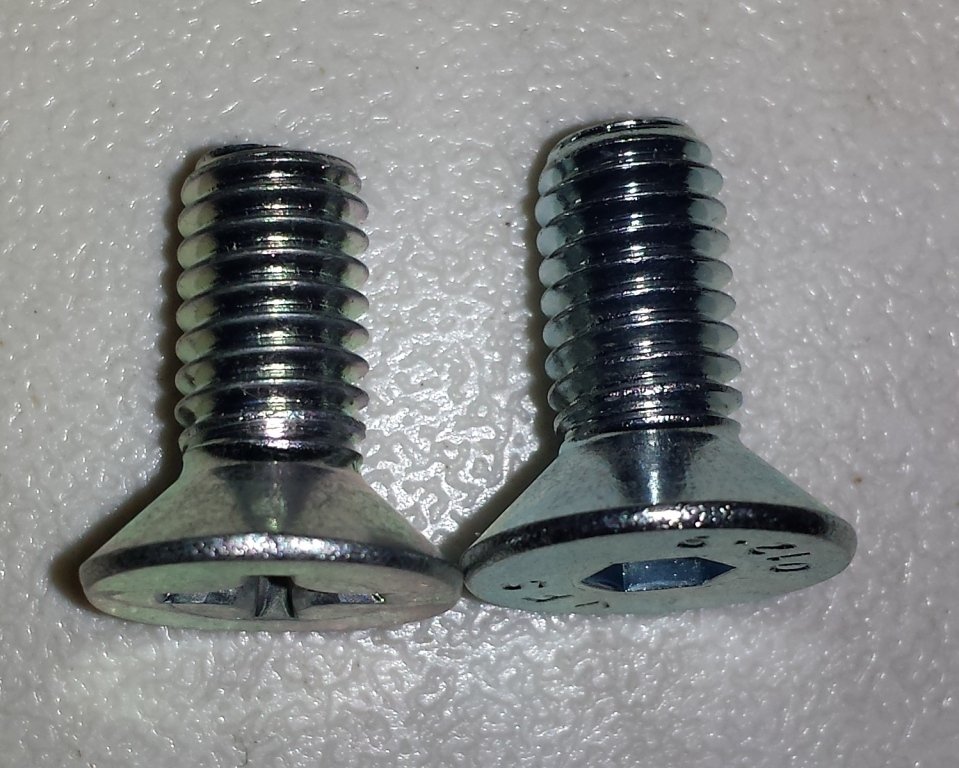

    Most people don't realize that Japanese companies use JIS (Japanese Industrial Standards) screws, not Phillips head. They look very similar, and I'm not sure which type these are because they may have been assembled in the USA. My Craftsman #2 Phillip head screwdriver is a little loose in the screw. My #2 JIS screwdriver and bit is a lot more snug. I'm hoping that they won't strip as easily with the JIS screwdriver. I'm not sure if this is why so many other people have trouble with them stripping.
    Here are some pictures of the screws. Left is the original type (93220-16014). The right are the replacement I'll use. They are zinc plated class 12.9 alloy steel, 6mm x 1.0mm, length 14mm from boltdepot. (On flat head countersunk screws, the length is the total length.) A 4mm hex key fits the socket hex hole (standard size for this thread size). The oil pump is held on with 9 of these screws. It seems like the timing chain cover and oil pump cover are aluminum, so a super strong screw isn't necessary, but I'd be a little worried that the hole on a stainless steel hex screw could strip many years after it were installed.
