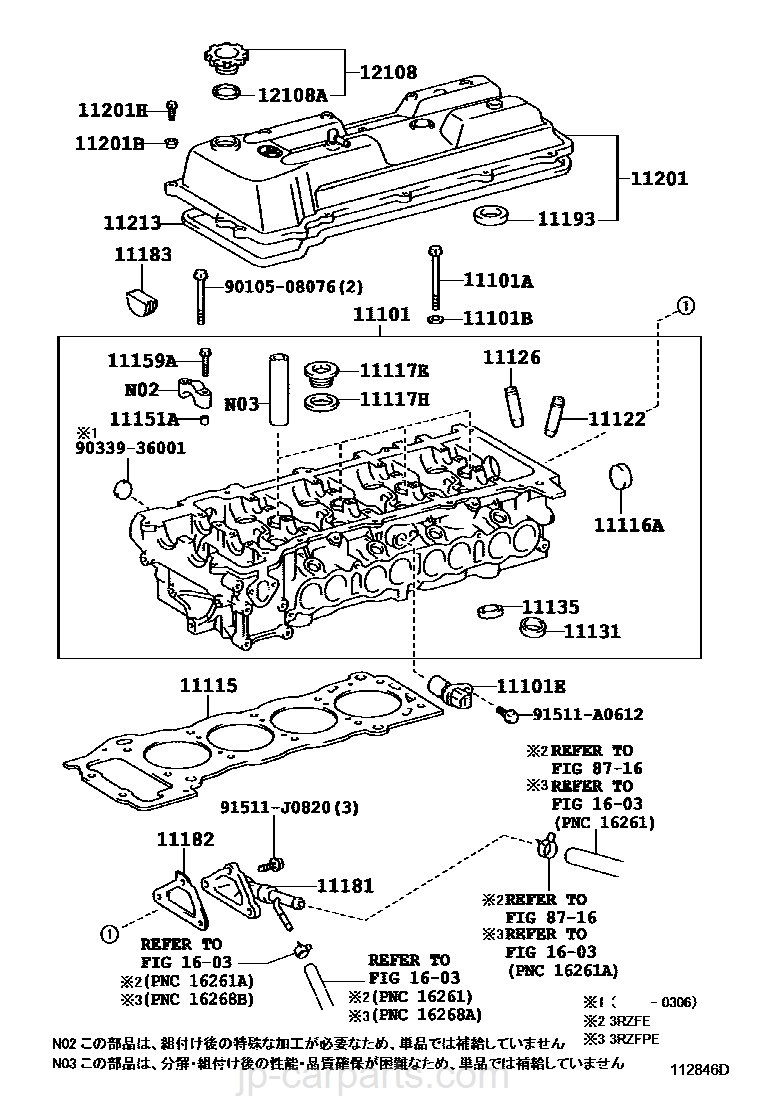

    Just posting this here for others in the future.
    The oil seal that is behind the coil pack mounting bracket is part number: 90339-36001
    I ordered one from Amazon here:https://amzn.to/4cV8Zfc where they call it an "engine expansion plug"
    This plug blocks off the hole where a distributor gear would pass through to the cam shaft. I'm not sure why toyota left this hole.
    I cannot find a definitive name for this seal/plug either. Toyodiy lists it as "standard part" and I cannot find it in any FSM.
    Here's a diagram that shows it from a Japanese website.
    EDIT: found a post here with the same leak
    https://www.tacomaworld.com/threads/oil-leak-help.467666/

    I posted this in the what have you done today thread, but I thought I would update it here as well.
    I drilled a hole in the center and it pulled right out with a pick that I had. I was prepared to tap the hole and try to pull it out that way, but it just came out so easy. I put some FIPG in the hole prior to tapping the new plug in, which was a much tighter fit than the original. I did it this way because I didn’t want to pull the valve cover since it wasn’t leaking and I didn’t want it to start!
