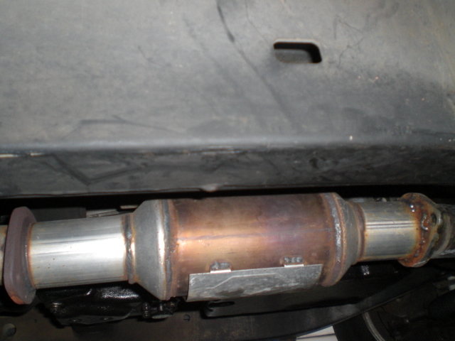

    Over last 4 yrs....since did mine...Two I know of from LCE........I noticed one a long time ago and he said if did not fit without some modifications.
    And one other that loved it.....think these were 3rz or 2rz...
    The flanges is whats different on different fabricators. Even though they are 2-holed, and tri-holed, they are not the same, and half the time one side has to cut off and straight welded together...
    I believe even on the walker, the mid pipe slip joint has to be tack welded to/around the muffler in 2 to 4 spots........so the excess water can still get out, and doesn't sit in muff.......most make mistake of clamping there.
    I wouldn't know if I didn't see em pissing all over the ground here in the humid south...
    Its worth going thru all this trouble, it'll run good and sound good, especially with the CIA.
