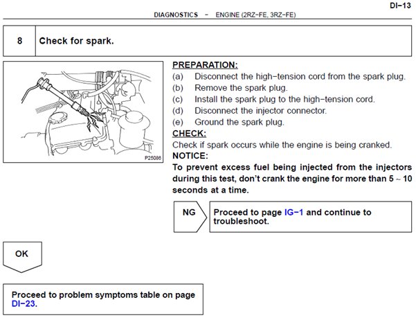

    It's getting spark for the three plugs and coils. They didn't spark when I had the EFI fuse/relay(?) out. I'm also smelling a bit of gas, so I think it's getting fuel. Does the #1 spark plug being stuck probably or probably not have anything to do with the engine issue?
    Here's a picture and instructions from the 1999 Toyota FSM.

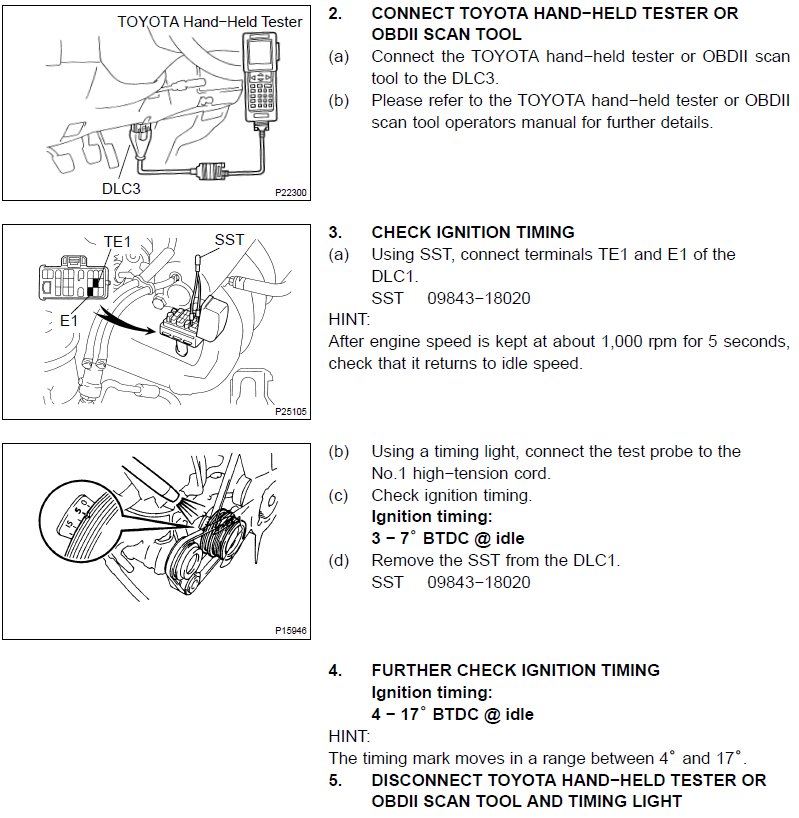

    Is there a way to check the ignition timing with a timing gun/light with plug-on-coil?
    Here's most of the page for checking ignition timing on a '99 3RZ, which has plug wires going from two coils on the front right of the engine. I'm not trying to do all of that, just want to see if I can get a timing light to work.
