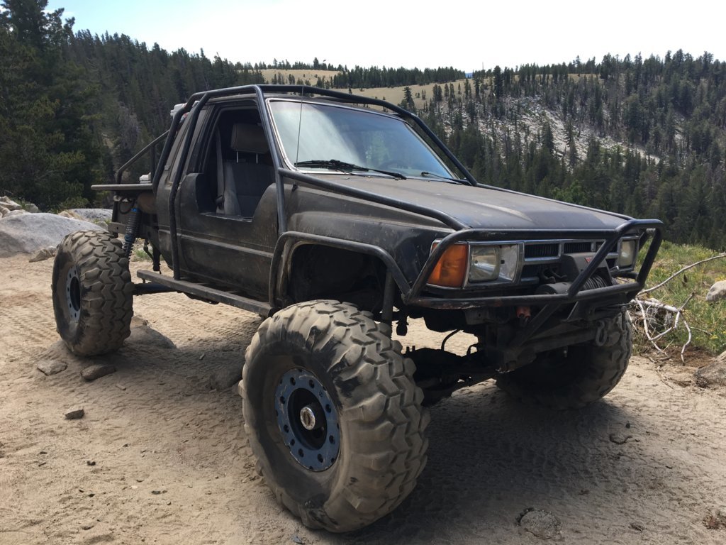

    Awesome feed back, thank you. The 3rz swag is Ca certified, so my goal is to do everything reversible, in the off chance I want to sell it. I'll look into the Halltech unit. Is the haltech preferable over the microsquirt systems?
    •If I go with a standalone computer are there injectors better suited than the pink tops?
    •On the turbo are saying the T2871 I was looking at would be too small? Looking at the turbo maps it seemed like the right size.
    •The benifits that I am seeing for external waste gates seem to be mainly at high boost. If I am running 6-10psi boost am I going to notice a difference.
    Here are a couple shots of the rig for those asking for picsIMG_7391.jpg IMG_6373 2.jpg
