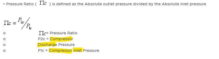

    PR is not a ratio of exhaust to intake, it's inlet to outlet of the compressor, so it's a function of atmospheric pressure and engine work, limited by wastegate control; so it's actually quite predictable. I still don't see why they would slap a relatively huge compressor housing on a restrictive exhaust housing that's incapable of flowing what the cold size could allow - there's no benefit vs a smaller compressor other than probably next to negligible flow loss.

    I mean it's not difficult to measure... I could go plot a realistic overlay on my truck and compressor maps right now (or I could guesstimate since I know my truck pretty well at this point)

    Incorrect, pressure ratio is the ratio of exhaust entering the turbo to the pressure of air leaving the turbo. 10psi of boost pressure to 20psi of exhaust back pressure in the turbo manifold equals a 2:1 pressure ratio. That's why people run exhaust map sensors to determine turbo efficiency. And the reason they would use that, along with different turbine wheels paired to the same compressor wheels, is to cover a large range of exhaust flow(displacement range) for the same given compressor CFM.

    Idk where you're getting this information, because even Garrett themselves disagree
    https://www.garrettmotion.com/knowledge-center-category/oem/expert/
    https://www.garrettmotion.com/wp-content/uploads/2019/10/GAM_Turbo-Tech-103_Expert-1.pdf
