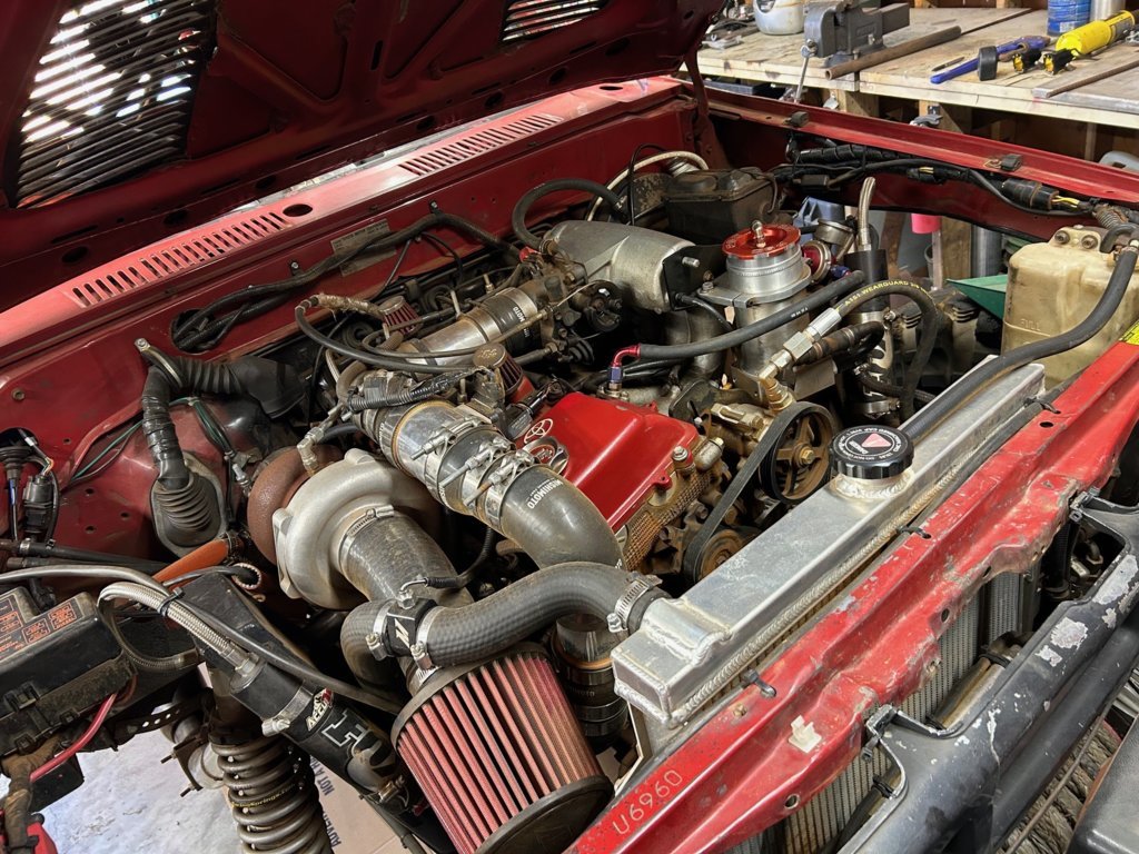

    #60
    Boomtacoma01
    Boomtacoma01 Well-Known Member
    Dec 7, 2009
    #27162
    1,377
    Houston
    Here is some motivation for you. We will be looking for progress.
