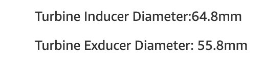

    The T30 maxspeedingrods turbos all had a larger turbine diameter of 65mm, which as I understand it would have slowed the spool time. With the exception of the new BB one https://www.maxpeedingrods.com/prod...-turbo-gt3071-up-to-30-bar.html?search=GT3071 which can be had with a discount code mid $500 range. I went with the pulsar tubro for a little bit more b/c it was well recommended & listed the compressor inlet as 3". However it arrived with a 4" compressor inlet so essentially the same specs as the maxspeedingrods unit.

    That turbo has the 65mm turbine Inducer. As it was explained to me on a 3rz this difference in wheel diameter is too big. Causing Lag. A 3071 has a 55mm/60mm turbine.

    gotcha. So I’m looking for something that has closer to the same inducer/exducer diameters with a 0.82 turbine housing.
    the 3071 has a 5mm difference between the two vs 10mm on the one I posted. I see now. I’ll keep looking.

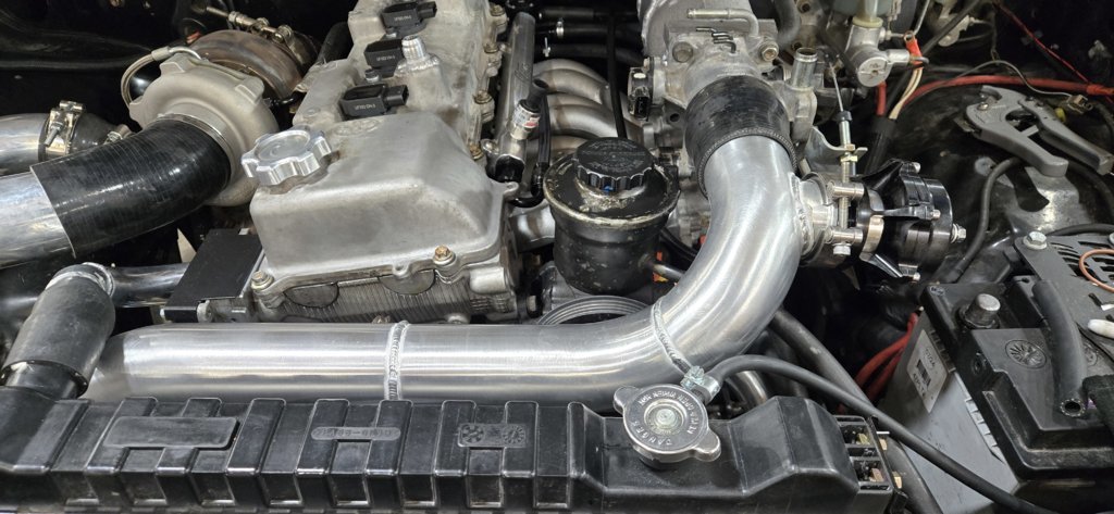

    Better to be overkill than underkill build 2.0 is coming together!20250331_202335.jpg

    Could you post a picture of the rest of the cold side and the full hot side?

    Of course! Anything specific you want me to try to capture? Just promise no hate on the early days stainless tig

    Just getting some Ideas for plumbing with a forward facing intake. Is that all 2.5" tube?

    2.5" piping, water to air intercooler, 3" downpipe, with equal length tubular turbo manifold.
