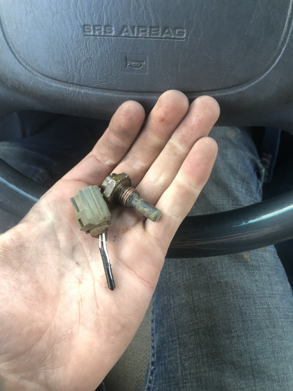

  12. Sep 28, 2019 at 7:31 PM
    fishinfinz
    fishinfinz [OP] Active Member
    Mar 27, 2017
    #214587
    36
    Travis
    99 Tacoma
    74464421-6F25-483C-A077-CA6D357CA00E.jpgWell I think I found the solution to my problem, thank you for the input from anyone who replied and to anyone in the future trying to chase down a gremlin like this check your coolant temp sensor, I found a tsb from the early 2000’s for this sensor and sure enough it was toast, I hope this can help
    Rachelsdaddy, DrZ and 0xDEADBEEF like this.
  13. Sep 29, 2019 at 6:58 AM
    Rachelsdaddy
    Rachelsdaddy Well-Known Member
    Jun 17, 2017
    #221707
    1,579
    Southern NH
    99 PreRunner 4x4 2.7
    Nice find, especially without a scanner. If yours had live data you would have picked that up right away. Best money you can spend on that truck is a live data scan tool. Less than 100 bucks.
