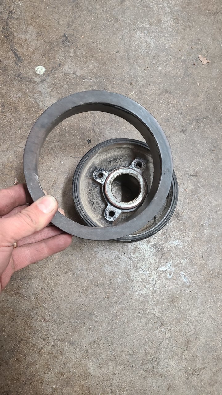

  3. Jan 2, 2023 at 4:17 PM
    #23
    bbeyota
    bbeyota [OP] Active Member
    Feb 8, 2021
    #355448
    32
    Sacramento
    04 Tacoma 2.7
    Um...I'm guessing this was the problem. Now to put it all back together. Didn't need HB remover, it pulled off. 20230102_161412.jpg

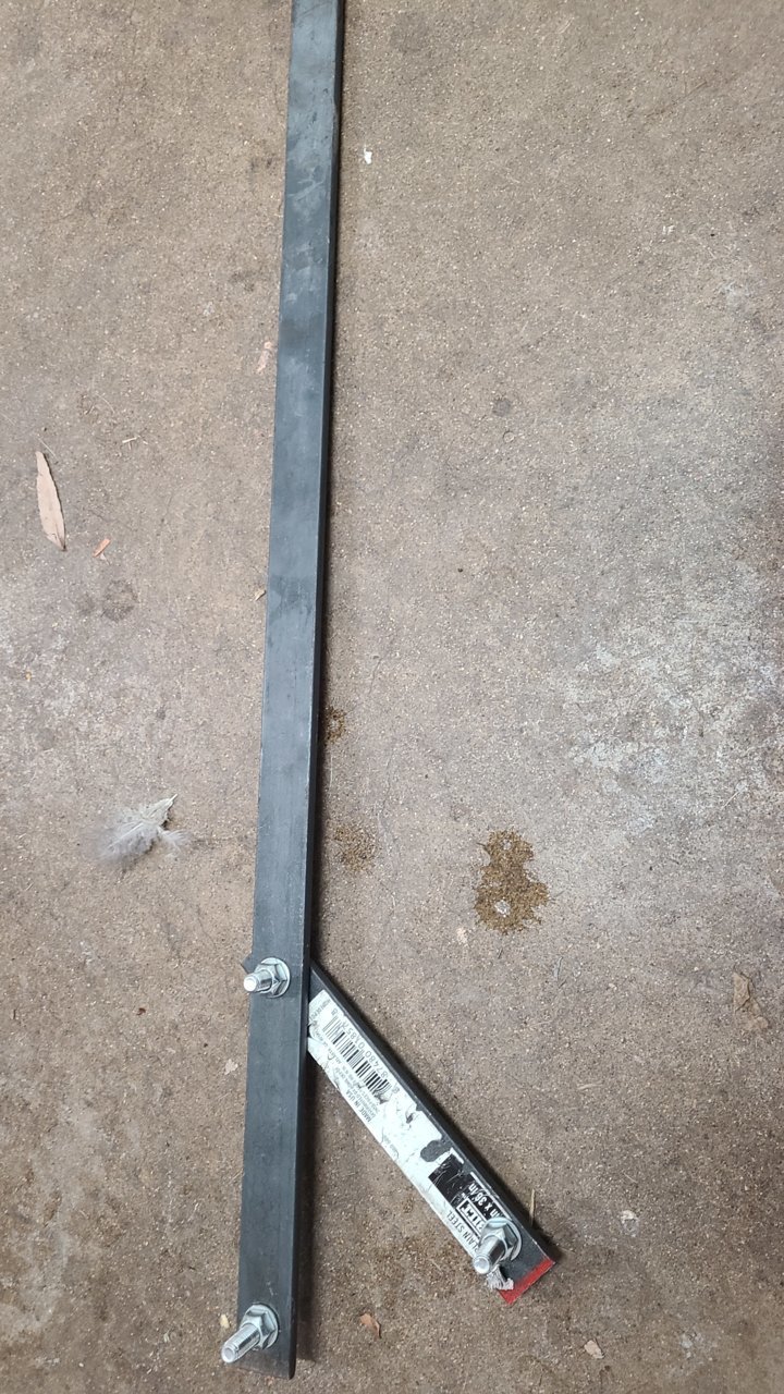

  5. Jan 2, 2023 at 4:26 PM
    #25
    bbeyota
    Feb 8, 2021
    #355448
    32
    Sacramento
    04 Tacoma 2.7
    I made a tool based on another members experience. If anyone in the sacramento area needs one, I will stash it. 20230102_162508.jpg
