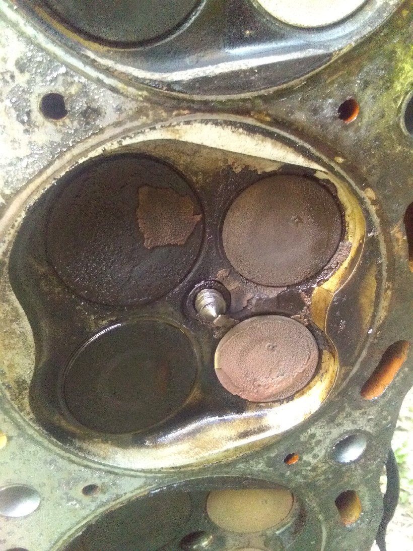

    Bumping this, can't seem to find much information out on these tubes. Broke a spark plug off in the head, then broke a screw extractor off in the broken spark plug... 300k miles thought it could use some new gaskets anyway so pulled the head, but now how to most easily get back to a clean spark plug hole... One (but just one) website on a search suggested that the tubes are threaded and could be removed with a pipe wrench. Others say they are pressed in. Has anyone here successfully removed the spark plug tubes from the 3rz head? Thanks

    leave the tube alone. remove it from the valve side, What is that jammed under the valve?

    drive the extractor out, soak that mofo with Kroil, can be bought at Napa, get a righr handed extractor (not those twisty crappy ones, the tapered ones with edge) warm with mapp gas or propane torch and back it out (clockwise from that side) I wish I was near, Id have it out in ten minutes

    Wish you were too! Ha thanks, yeah it's getting the extractor out that's the trouble right now, it's broken off flush down in the tube and not sure how to get a bit started on the pointed end. One of the other plugs was rusty so pretty sure that's what's going on rather than cross-threaded

    you can drive the extractor out with a punch, it will pop right out
