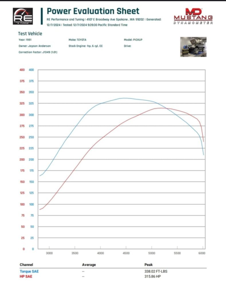

    I am unfortunately one of the folks who've purchased a supercharger for a 3RZ and can attest that they aren't all they're cracked up to be. In fact overall they're still pretty slow even at 7psi. The TRD/LCE/Alpine unit is an MP62 not an M90, if it were an M90 it would be more appropriately sized for the engine and make less heat for the same power gain. I'd personally go with a turbocharger on the 3RZ, it likes boost well enough and even with a 2RZ on 14psi we squeezed out 316hp and 338lbs of torque at the wheels.
