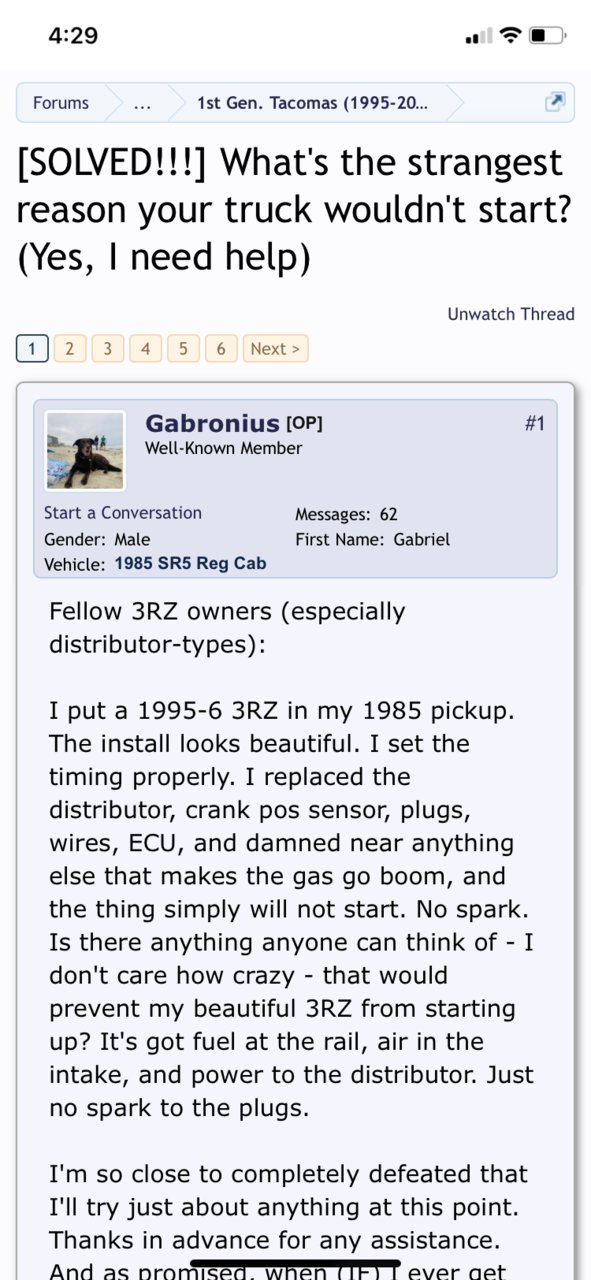

    This sounds exactly like an older thread I was following a while back, long read but maybe some ideas. If I knew how to link it hear I would but you can find it with this screen shot. C6EC572D-8418-4D98-92C9-A9819FCF2E22.jpg
