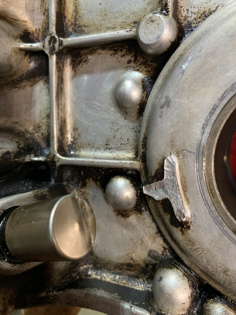

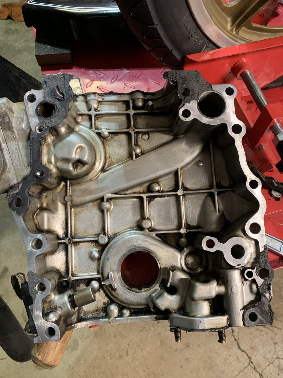

    Had a timing chain failure on my 2.7l 3rz and was just looking for some input before I reassemble. Casted into the cover is a tab that broke off when I had my timing chain fail. I’m 50/50 right now on getting a replacement cover but was just curious what y’all thought? My guess is it just protects the sensor from junk getting tossed off the chain? I will be replacing the sensor since it was damaged in the failure. CAAF1076-9F7D-4404-BCD1-1CEE34233CCE.jpgB01699A4-AA55-42E2-A5EF-1AB0AFAD6F53.jpg Thanks in advance!

    Just really wondering if y’all would run it and not worry too much or for sure replace it? I already found the chunk missing and removed it too fyi. Just don’t want to get another if I don’t have too. Thanks!

    I don’t see why not. I don’t think it’s a guid for the chain, up to you. When I rebuilt my engine I replaced everything that had me second guessing, if it was good or not. Didn’t want to do it a second time.

    Was that tab breaking off the cause of the chain failure??
    If not what was the cause?
    My luck I would not replace the cover would crack in a few weeks.
    look for a used one.
    Good luck!

    The place I've seen these crack is right around the the crankshaft opening...
    round hairline crack......so check around that real close....
    But that's usually from a wobbling harmonic balancer on its death throws.....

    Ended up just replacing the cover since it was only $75. Not worth it to not do it and have in the back of my mind. Trucks back up and going now and I feel good about about not risking it. Yay.
